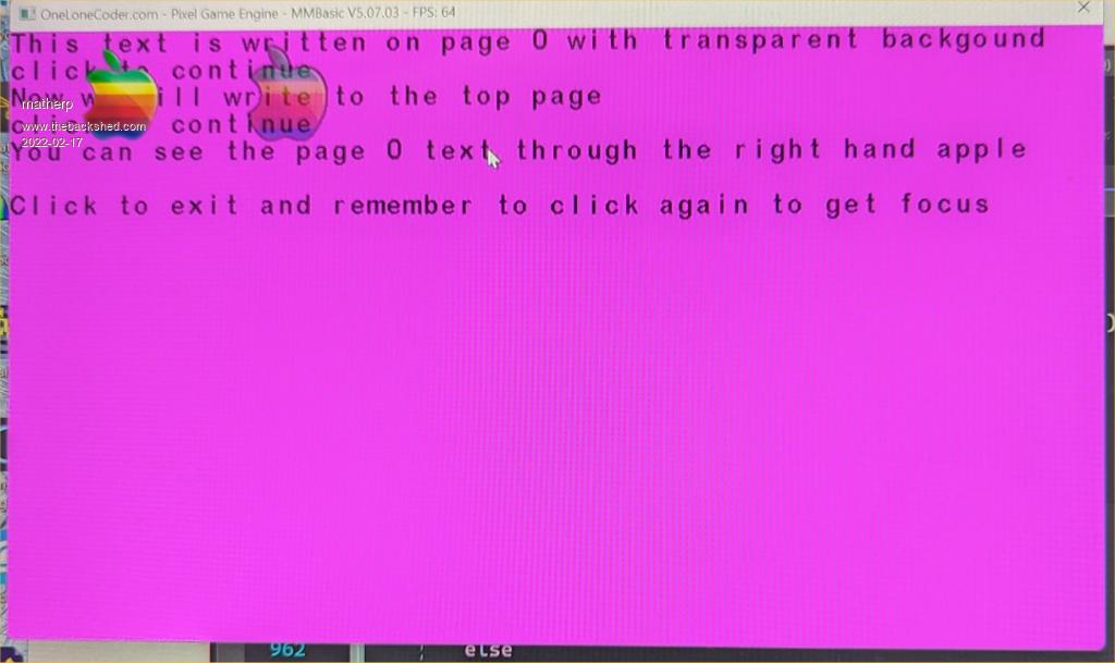

The MMBasic for Windows code is now officially past the pre-alpha phase and enters alpha. i.e. most of the functionality is now there and there are not too many reports of issues but there is still work to do.
The big change in V5.07.03a0 is support for proper transparency as per the CMM2
The mode command is changed as follows to follow the CMM2 as closely as possible:
MODE modeno [,alphaenabled] [,background colour]
By default alphaenabled is 0 and the background colour is BLACK
To use the second layer set alphaenabled to 1 and optionally choose a background colour
Unlike the CMM2 MMbasic for windows uses full ARGB8888 colour in all modes and has a transparency value (A) of 0-255
When you change the mode to alpha by default you are still writing to page 0 and it is cleared to RGB(BLACK)which is opaque. If you want to see the background colour pixels on page 0 must be written with a transparency of less than 255. Use CLS RGB(BLANK) to clear a page to completely transparent.
If you set to write to page 1 this will overlay page 0 and the background to the extent that the alpha value of the pixels on PAGE 1 are set (between 0=transparent and 255=opaque).
Note when playing with this at the command line you can get very confused so it is easier to understand what is happening with a very simple program.
mode 14,1,rgb(magenta) 'set into 2 layer mode with the background set to magenta
font 3
print "Click to get focus"
mouseclick
print "now we will clear page 0 to blank"
print "click to continue"
mouseclick
cls rgb(blank)
colour rgb(black),rgb(blank)
print "This text is written on page 0 with transparent backgound"
mouseclick
print "Now we will write to the top page"
mouseclick
page write 1
cls rgb(blank)
sprite loadpng 1,"apple"
sprite write 1,50,10,1
sprite transparency 1,128 'change the transparency of the sprite
sprite write 1,200,10,1
page write 0
print @(0,mm.info(fontheight)*4)"You can see the page 0 text through the right hand apple"
print
print "Click to exit and remember to click again to get focus"
mouseclick
sprite close all
mode 14
colour rgb(white),rgb(black)
end
sub mouseclick
do
loop until mouse(l)
do
loop until not mouse(l)
end sub
apple.zip

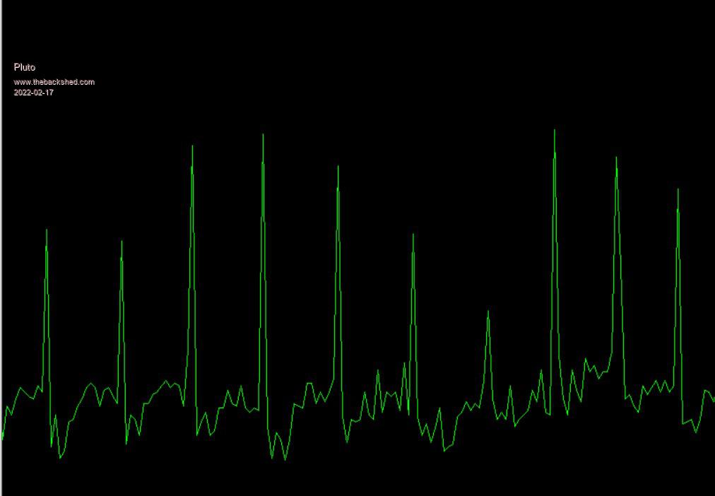

Posted: 08:09pm 16 Feb 2022
Serial communication works well up to 230400 Baud (with a Microbridge). For higher speed, do you think an other type of USB-TTL like CP2102 would help? Any ideas where the bottleneck could be?
Tested with an old DIY ECG. Faster datastream would be needed for diagnosis; but at least i can see that the patient is alive.
Regards Fred
