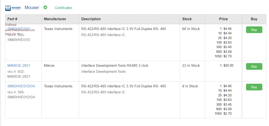

@Volhout...Good call
I was certain that I checked Mouser

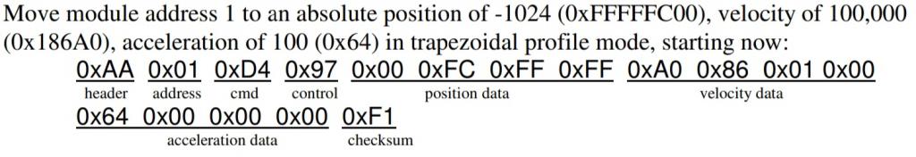

I use a binary protocol with a simple checksum. I adopted it from "NMC" (network motion control). Never experienced a checksum error and if I did, that would indicate an electrical failure and the machine would simply shut down. Here is an example:
That is an example of a command to move a motor. The motor could be a CNC axis or a robot, etc.

The checksum is across all except the header I found out. That makes sense. The header is to wake devices, and prepare to read the address, and act on it.

Yeah AA = 10101010
Also the "D" (decimal 13) in the "D4" CMD byte indicates that 13 data bytes are to follow, prior to the checksum.
