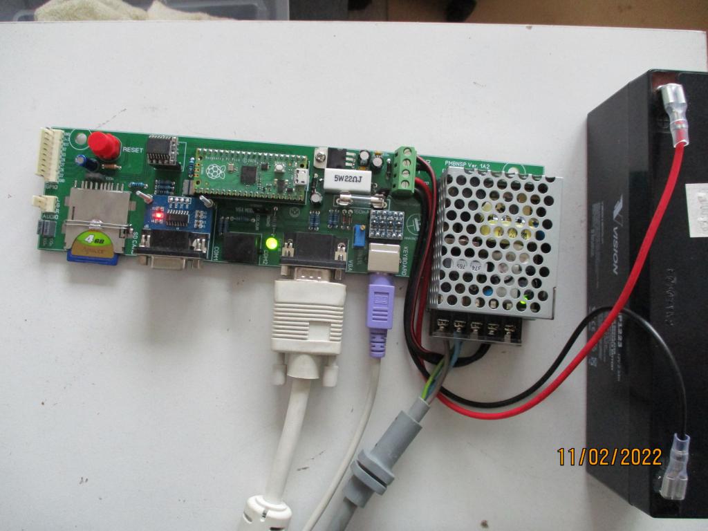

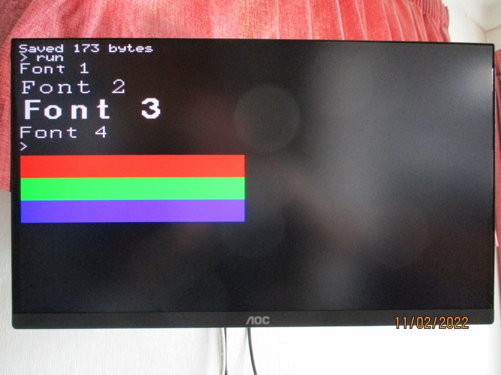

I have finally finished building and testing my new PM VGA prototype board.
Everything went smoothly, and the VGA output from the PM is very stable and crisp.
An amazingly fantastic use of the otherwise unused 2nd core in the RP2040 chip.

Any schematics for this board ? You are trickle charging the lead acid battery ?
What is your audio output circuit ?  This looks like something I would build for myself... so that is why I am asking.

- No schematic yet, as this is just a prototype so not even sure if it will go past this point.  Well, I have a scribbled version, but not in the CAD yet.
- Yes, I am trickle-charging the gel-cell via the 22R five watt WW resistor.
- Audio output as per Peter's PM schematic.  Nothing different there EXCEPT I have added a couple of output coupling capacitors on the audio lines to provide DC isolation to any amplifier stage I plug it into.

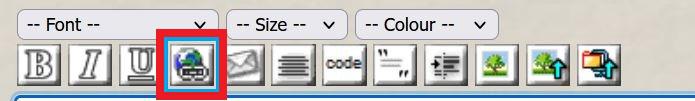

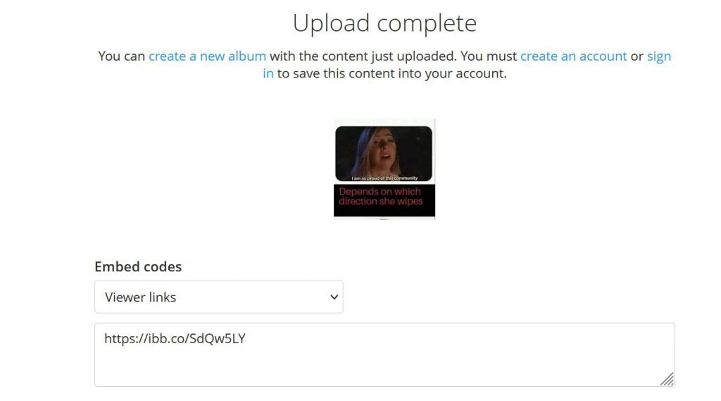

If you use imgbb.com and post it here as a web link it won't resize to upload the picture
when you've uploaded the picture choose this
then use this to share the picture link here

Neat looking board - what are the PCB dimensions? From the shape it's probably designed to fix some type of enclosure with the battery etc?
I have been thinking about using that same RS232 module - did you cross connect RS232 module TX to Pico RX etc or connect "straight" i.e. RX to Pico RX?
I cannot find a schematic for this module and have had an experience where an RS485 module did NOT need to be cross connected since the pin labelling was from the MCU's point of view (i.e. connect RX to MCU RX, TX to MCU TX).

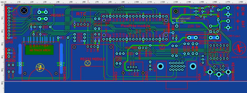

CAD drawing external link test:
ADD IMAGE button method:
This method does not seem to work, despite pasting in the public link.
This is the link I tried to use for the ADD IMAGE button:
https://www.dropbox.com/s/2a4sdmleyxea44e/PM_PT_GIF.gif?dl=0
ADD HYPERLINK method:
PicoMiteVGA Prototype CAD image
Edited 2022-02-12 11:27 by Grogster

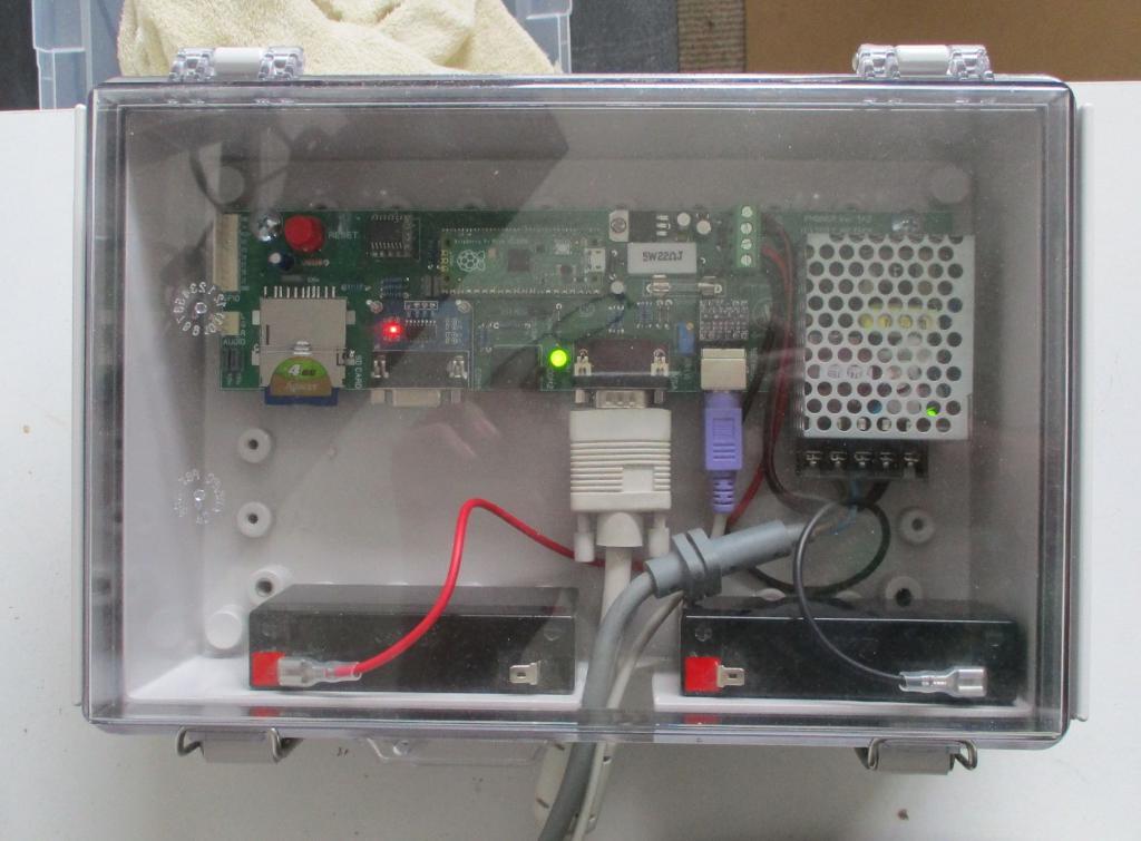

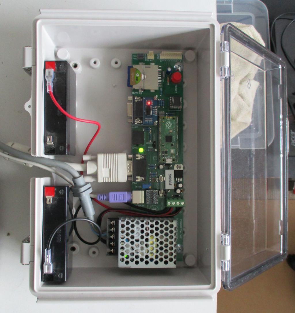

Prototype inside its box:
Batteries not yet connected at the 0v point.
I'm using 2x 6v gel-cell batteries in series mainly due to lack of space inside the box.

This is a really cool design, I like the idea of the RS232 COM port because you can cover quite long distances! Does it work properly with the picoMite? I am planning to use it, too. For what application do you plan to use this device within this box? Looks interesting.

Posts: 10076
Posted: 04:58am 14 Feb 2022
  Amnesie said  This is a really cool design, I like the idea of the RS232 COM port because you can cover quite long distances! Does it work properly with the picoMite? I am planning to use it, too. For what application do you plan to use this device within this box? Looks interesting.
- Daniel
Sorry - forgot to answer this question.
Yes, RS232 port works fine with the PicoMite.  The important thing is that you use a module based on the MAX3232 chip.  The MAX232 does not run from less then 5v, but the 3232 runs down to 3v minimum, so it is happy at 3v3.
I needed an RS323 COM port, as this will be connected to a pager transmitter that has an RS232 interface, so will not work with CMOS 3v3 or TTL 5v.
The little blue module converts the 3v3 from the PicoMite to RS232 level, and also 'Down-converts' the RS232 replies to 3v3 for the PicoMite to read.
COM2 is a standard TTL(5v) interface for a receiver module.  It is level-shifted to 3v3 for the PicoMite via the Level Corrector module.
