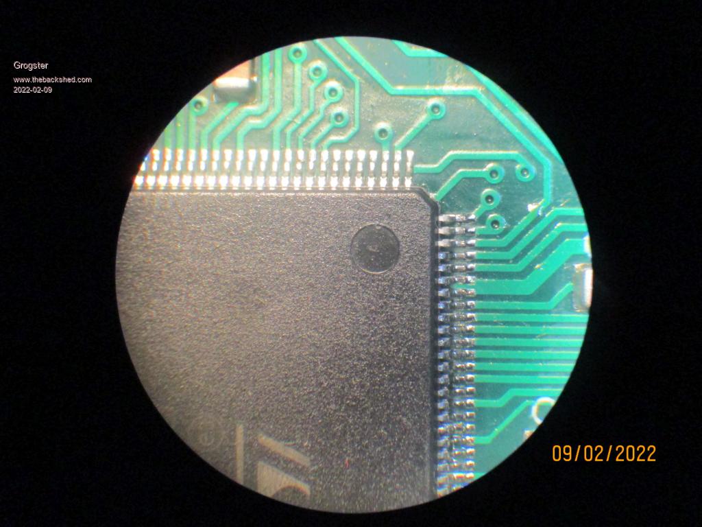

I have ten boards I had made at JLC, less the ARM processor chip, as they were out of stock.
The ARM processor is out of stock basically everywhere, but I have ten chips I ordered from element14 before the stocks were totally depleted, and they have arrived this week, so I thought I would have a go and see just how hard it was - or not - to hand-solder this 176-pin beast.
Actually quite easy, using the standard drag-solder technique at 90-degrees to the pins.  Can drag-solder each side of the chip in about 5-10 seconds, so the entire beast in less then a minute.
This unit programmed fine, and has passes the QC testing, so I will be sending it off to one of my back-order clients in the next few days.
I have ten units to build by manually soldering the ARM processor chip, but the first one was easy enough, so I don't expect the others to be any more difficult.
JLC were also out of 8MHz crystal oscillator packages, so I had to manually hand-solder that also, but happily, everything worked as expected.
Once I send to my back-order list, I will then have seven CMM2 units to sell on my website if anyone is looking for one.  Back-orders accepted for these last seven that will be available between now and about this time next year - IF they don't push the delivery time back even more.

Perfect soldering !! Absolutely flawless.
Did you use leaded solderpaste (looking at the gloss, you did). Or is this the copper based solder?

That's very nice indeed. Do you use a cup-end bit for drag soldering?

Good job, Grogs! I did probably 50 this way. I make a smooth motion across the side with a soldering iron at an angle to the comb of the pins, leading the iron tip with fine solder. Takes seconds. Usually leaves the last two pins bridged, but that is a fast fix.

  Grogster said  I have ten boards I had made at JLC, less the ARM processor chip, as they were out of stock.
Good job! I find lots of liquid flux helps me solder things like that.

Thanks for all the nice comments.
I never wanted to hand-solder this beast before in the past, as the shear size of the package and number of pins, gave me nightmares of it being somehow more difficult to solder then smaller pin-package chips.  I was totally wrong on that - they are just as easy as the smaller ones, so I was deluding myself there.
To answer the questions:
- No to solder paste, just standard 60/40 solder on the iron tip.
- Standard screwdriver bit, not a well-based or cup-based one, simply as I don't have one.
- Yes, plenty of flux.  I use CAIG Brand Rosin Soldering Flux gel, as it does not evaporate like liquid flux can before you are ready for it.
Once soldered, spray with PCB solvent and using an anti-static brush(and wrist-strap on yourself, naturally), clean off the flux residue to leave a nice clean looking result.
I have a roll of 0.38mm 60/40 solder I use for this kind of thing, as with thicker solder, it is way too easy to put too much on the tip, then you get pin-bridging all the way along.  0.38mmm or thinner multicore 60/40 solder is expensive compared to the standard 0.71mm rolls, but it is well worth the expense, as it makes soldering SMD chips especially, much, much easier then with the thicker stuff.  Even if you are being very careful, it is just too easy to put too much solder on the tip with the thicker stuff.
With 0.38mm solder, and just a tiny bit on the tip, aided with flux, it just flows to where it needs to be, and the surface-tension means it sticks to the pins and board, but does not bridge between pins.  As mentioned by CG, with a chip of this size, you do have to top-up your solder about half-way down each side as you run out with that many pins!  Would it be narcistic of me to say that I did not bridge a single pin on this first chip?
But pin-bridging is simply a fact of life when hand-soldering 0.5mm pin-pitch, so I expect I was just lucky on the first one!
I did need to reflow a couple of areas that I was not happy with - dab more of flux, tiny bit more solder on tip, and re-drag just that area to get a nice consistent result.
I tend to use the "In-and-out" soldering method with SMD chips usually, where you bring the iron in and out in parallel steps to the pins, working your way down, but drag soldering is much faster on a big beast like this chip, so.....
I probably should drag-solder more then in-and-out in light of how easy and fast it is with a pretty good success rate!
I used to hate drag-soldering, as I tended to make more bridges then with the in-and-out method, but perhaps I have perfected my technique now!
