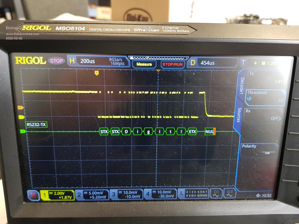

I use this Version of : PicoMite MMBasic Version 5.07.04b1
My wish is to output a text on the serial interface.
Later I would like to realize a fast communication with the PC at the USB port.
I noticed that something is wrong at the end of the bitstream.
It looks like 2 bytes are always missing and an error occurs because the last character is recognized as NULL.
The delay at the end I get away with a pull down I've tried.
Is it me or is there a microbug in the firmware.
BTW it is a great job from everyone involved - a big thank you!
SetPin GP13, GP12, Com1
Open "COM1:115200" As #1
 Print #1,Chr$(2);
 Print #1,Chr$(2);
 Print #1,"Digit";
 Print #1, "!";
 Print #1,Chr$(3);
 Print #1,Chr$(3);
 Print #1, "!";
Close #1

yes that is odd. the Tx line is normally/should be left in a "marking" state; that slow tail off will leave the Tx line in a bad state for the next line. I don't know whether that is the effect of closing the channel (try again without the Close#1) but it doesn't sound right. It makes sense that if the pin is defined as a serial Tx it should adhere to the standards until re-assigned regardless of whether the channel is open or closed.
Also; try putting DO:LOOP at the end of your prog just in case it is something to do with the interpretter returning to immediate mode.
I suspect the NUL is just your analyser doing its best to make sense of the incorrect state and not a "real" character - the very slow fall doesn't match the rest of the data edges
Edited 2022-02-02 20:39 by CaptainBoing

Posted: 10:38am 02 Feb 2022
Hi, Captain B. thanks for your reply.
I can live with the delay.
The much bigger problem is that the last two characters are missing there.
The "ETX" and the "!" to the end.

Posted: 10:42am 02 Feb 2022
serial comms are "slow" and I wander if the close and/or then the end of your prog are somehow abandoning the send.
Things to try:
* Remove the close#1
* Put a pause in before the close#1
* put the prog in a loop at the end rather than allowing it to implicitly end
Closing the serial port will put it into undefined or high Z state.
Use a pullup to hold it high and you have to redefine the pins before trying to use the port again.
Posted: 10:47am 02 Feb 2022
That certainly matches what OP is seeing Jim, good call
I guess I have never seen this problem because I don't think I have ever used Close#n - open the serial port and leave it like that

Posted: 11:09am 02 Feb 2022
Hi all,
This was discussed before, I proposed to release the IO pins with a new Setpin command, but keep them connected to the UART at "Close".
Peters comment was that that was not his intention. His response was that you need to have a pullup to "idle" state anyway, otherwise the lines are not defined BEFORE you open the UART. So if you add a pullup, the system is well defined before AND after UART communication.
In your case the IO lines are immediately released (the "close") before the UART has transmitted all buffered content. Since you have no idea how much is in the UART buffer, it may be hard to do anything to guarantee all is sent.
Maybe it is better to check if all is sent before closing the COM
P.S. This thread confirms that others may have a problem with this software implementation. Maybe is this thread changes Peters intention, although he is very occupied with MMB4W at the moment.

Posted: 11:29am 02 Feb 2022
Could the missing characters at the end be the result of the port closing before the transmit buffer is empty? A short pause before closing should fix that, along with the pullup previously mentioned.
PAUSE 0.2 'mS should be enough to send 2 bytes at 115200 baud.
