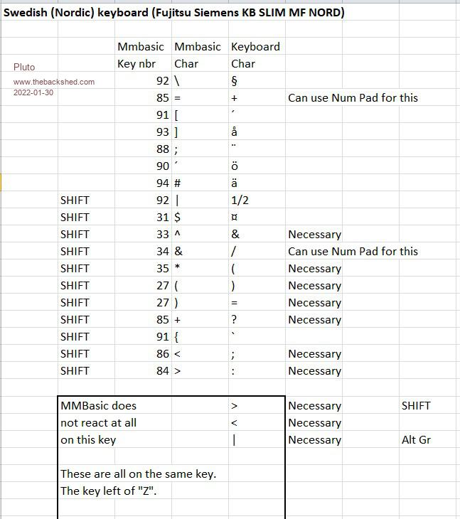

Posted: 07:47pm 29 Jan 2022
These are the keys that need some fixing.
As you can see there are several differences between what MMBasic displays and what is shown on the keyboard keys. I do not think that all need to be "translated". Indicated the necessary ones in the table.
The "<, >, |" key has no action at all in MMBasic.
Hopefully you can interpret my table. If not please advice me how to present.
/Fred

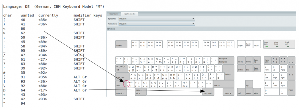

Posted: 08:29pm 29 Jan 2022
Correction table for my German keyboard (MMBasic V5.07.03pa3)
"^" = Shift
"^^"= AltGr
MMBasic V5.07.03pa3
Ascii(MMBasic)
92  should be 94  = ^
^86  should be ^59 = ;
^84  should be ^58 = :
89  should be 35  = #
^89  should be ^39 = '
85  should be 43  = +
^85  should be ^42 = *
^^85 should be ^^126 = ~
93  should be 180 =  (suggestion: ^39 = ')
^93  should be ^96 = `
91  should be 223 =  (suggestion: 92 = \)
^91  should be ^63 = ?
^27  should be ^61 = =
^^27 should be 125 = }
^36  should be ^41 = )
^^36 should be  93 = ]
^35  should be ^40 = (
^^35 should be  91 = [
^34  should be ^47 = /
^^34 should be 123 = {
^33  should be  38 = &
^30  should be 167 =  (suggestion: ???)
^^64 should be  64 = @
90,94,88 (are german Umlauts)
The key ("\"+"|") below the "A" and to the right of the left shift key gives no answer.
Should give:
60,^62,^^124
Work in progress. I must have missed something ...
@Admin the board software multiplies the backslash \ if I edit my post.
Edited 2022-01-30 07:47 by twofingers

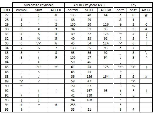

Posted: 02:26am 30 Jan 2022
my config : French keyboard AZERTY
keyboard.zip
Edited 2022-01-30 12:31 by goc30
