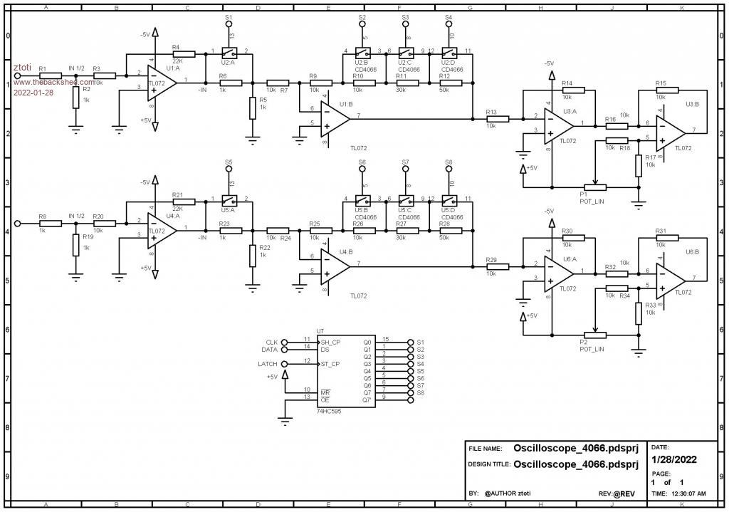

Hi there,
This is a question for Peter:
I used your Cfunction Scope for PIC 32MX470 and I can say it works great, I'm so happy with it.
Now with all this corona situation:
1. I can't find PIC32MX470 in DigiKey
2 RPi PICO is 1/2 of the price of PIC32MX470
I know you are so busy with MMBasic for Windows, Linux, Picomite... but is there any chance to "translate" this beautiful Cfuncion for Picomite?

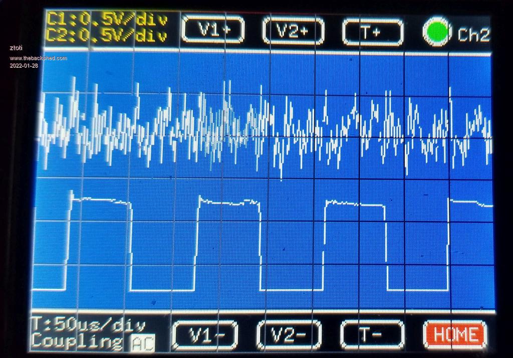

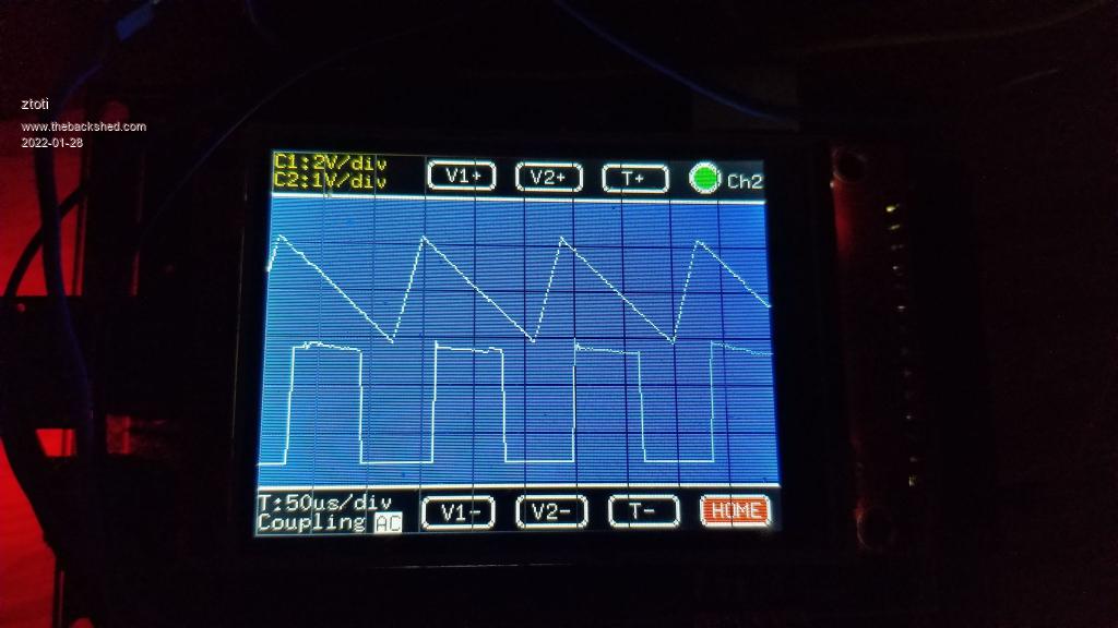

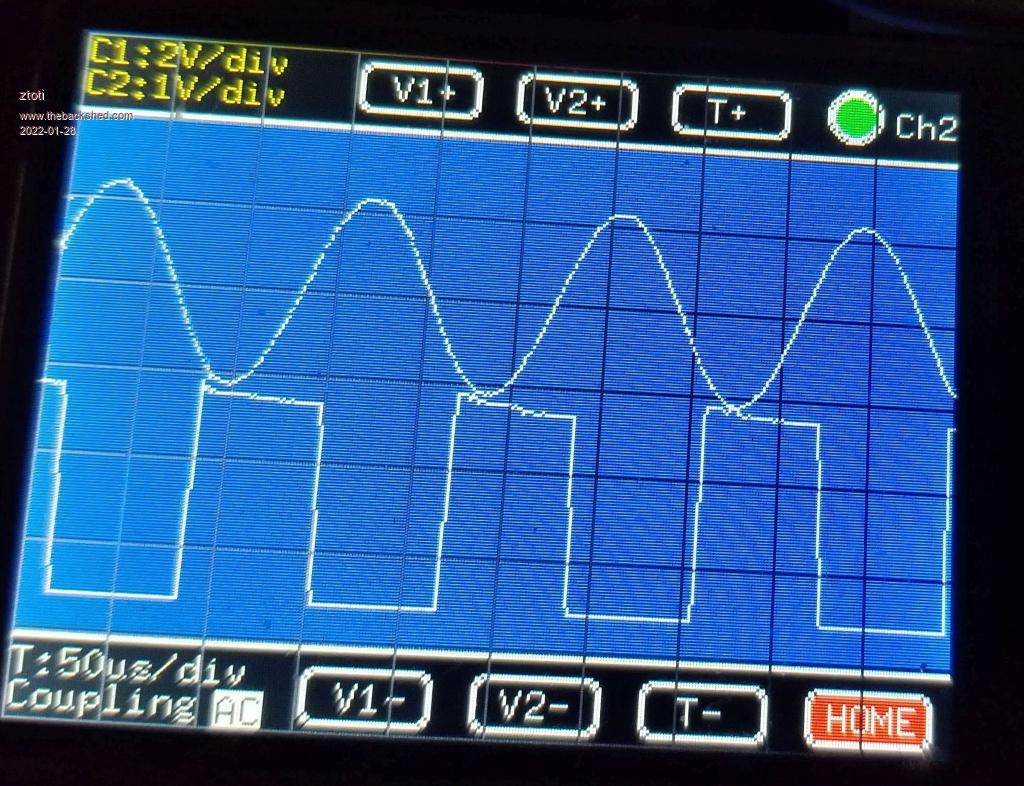

Attached are the pictures from my GUI for the scope and gain (div/v) amplifier.
Thank you

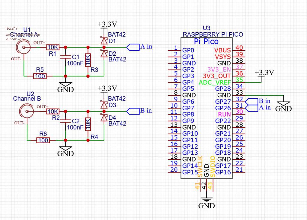

a cheap dual channel oscilloscope would be brilliant if it could be made to work with higher voltages which should be easy with a voltage divider circuit but there must be a better way
The pico can run at 300Mhz and still use it's flash memory, and up to 420Mhz but unable to talk to the onboard flash at that speed so it could be pretty good as an oscilloscope
This is as far as I've got circuit wise so far
Anyone got any ideas for a better circuit to allow measuremeant of higher voltage lines?

If you want higher voltage inputs then you *need* a voltage divider. It's how you generally reduce voltages. :)
Note that ztoti's circuit is using op-amps with both positive and negative supplies. This allows the waveform to be both positive and negative relative to gnd e.g. AC supplies and signals.
I'd recommend that you also put a 3V reference like the LM4040-3V0 on the REF pin then use OPTION VCC 3.0 and treat your ADC inputs as 0-3V. You'll get a more accurate and stable reading.

@lew247
C1 & C2 will reduce noise at the expense of bandwidth.
CRO voltage dividers usually have trimmer capacitors across R1 & R2 to compensate for input capacitance. To get maximum bandwidth you need to form a capacitive voltage divider equal to the resistive one.

You only need to capture and store a screen width's of values. So, using a 800x600 display at full screen size that's only 800 words of storage, assuming you use the full 12-bit range of the PicoMite's ADC. If you can capture 1600 words that's better as you can zoom x2 on the screen.
You can capture the values into an array then display them to allow the lowest CPU load. Rinse and repeat. :)
The input should have 1M input resistance to work with "real" probes. Any voltage divider should match that. e.g. 820k / 180k. A small trimmer capacitor across the 820k would give some high end compensation, even better with a second cap across the 180k. Then straight into a non-inverting buffer. This will usually give you the highest bandwidth that the op amp can manage. If you fancy an attenuator that's a bit beter, this looks promising.
The input should be able to swing both positive and negative to be able to drive the ADC over its full range - and stay within the op-amp's output range. Consequently you'll probably need a minimum of +/- 5V for the op amp supplies as it's unlikely that you'll find a good one that can reach its supply rails. (I like your circuit, ztoti! It does all the important things. Might be worth a better op amp though, even if you have to go for higher supply rails.)
