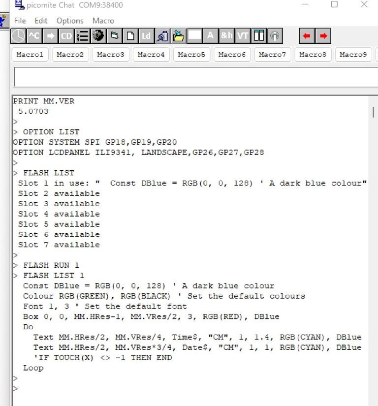

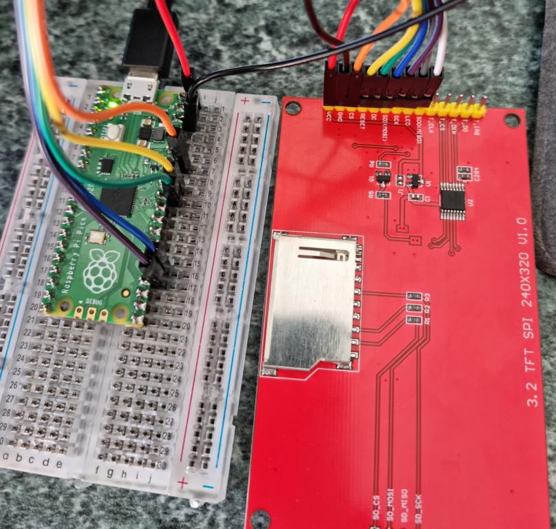

I have just received some LCD screens through Aliexpress and I cannot get them to work. The screen lights up when the Pico is powererd up and there is a very brief scrambling of black lines and then it reverts to a white screen.
I have tried connecting as per the Picomite manual as well as the Silicon chip article but no go.
I am trying to get it working as a display only first and once that is working I will try my hand at touch and SD. That brings me to another point, the website says this LCD is "no touch" yet it looks suspiciously like it has that option. Can anyone confirm this from the pictures which I hope have uploaded successfuly?

The board appears to have the touch chip fitted, but to see if the touch foil is also fitted look at the top side, connector end there will be a four way flexible PCB strip running from the top of the panel and down under it.

Don't know that it would make a difference, but MISO appears not to be connected.
Also, although the Picomite manual shows GP20 as a MISO pin, the PICO pinout image that I have followed doesn't.

  lizby said  Don't know that it would make a difference, but MISO appears not to be connected.
As I understand , MISO is not used with displays ....
It would be transmit from the display ( doesn't happen )

When powering from 3.3v you should bridge J1 which bypasses the regulator. Normally seems to work without doing this, but should be done to ensure you are getting 3.3v
It seems to have the touch chip, if on the screen side you can see a separate 4 wire ribbon going to the top layer of the screen then it likely to have touch.

(You need MISO connected to read the pixel. Is your white wire going somewhere we can see?)

In the TEXT line you have "CM" I think it should just be CM no inverted commas.

As I understand, MISO is used for BLIT READ (but isn't needed if you only write to the display--thus "Don't know that it would make a difference").

I have never used the "" with the alignment but apparently it works either way.

I checked the front of the screen and it does have the the Touch 4-conductor ribbon to the top.
I am powering from VBUS, so it's 5V. I also tried using an externally powered USB hub.
MISO not connected. (as per Silicon Chip mag)
Tried the Pixel command and it returned FFFFFF
Removed the inverted commas from both CM's and no change
Is there maybe something I am doing wrong with MM Edit

Try
GUI TEST LCDPANEL
That tests the display without having to worry about programming issues.

I later noticed a solder jumper on the board "J1" and bridged it out with a little solder and now for a very brief time when powering on it displays the date and time as per the program but then it goes blank again. Progress I suppose.
Any ideas?

The jumper brides out 2 of 3 pins on a small smd component, "U1", which is a "662K"
If I am correct this is a voltage regulator and it bridges the in and out pins.

"If I am correct this is a voltage regulator and it bridges the in and out pins."
Yes it does, if powering from 5V that will damage any 3.3V item attached such as SD card and PicoMite.
Only bridge J1 if using 3.3V. Most use 5V with J1 open.

To see if that regulator is working measure the voltage on both pads of J1. There should be 5V on one and 3.3V on the other. The metal case of the SD socket is a good ground point.

Is the backlight lit? Try a 100R resistor from the LED pin to 3V3. Failing that, try it to GND instead. I don't think I have a circuit for the 3.2" display.
Some of the displays use a simple resistor to set the brightness but Q1 isn't fitted. Where Q1 is fitted the backlight is powered via that and you can connect the LED pin to a PWM output to dim the display.
