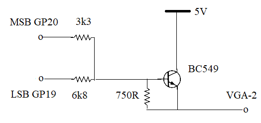

That 27ma can be saved from 3.3V supply and Pico output budget by using 3 NPN emitter followers with collectors to 5V for the VGA. The green resistor network will need recalculating. Emitter direct to VGA-G pin and a resistor base to emitter as a load for the network . The emitter resistors for R & B = 220R.
Re post when I sort out the values.
Edit
I think this will be adequate (untested). The values can be adjusted for improved balance by trial and error.
