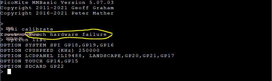

Hello,
I've tried to configure ILI9488 display with my previous ILI9341 setup ( ILI9341 works great), but after GUI CALIBRATE, I touched first two targets with no problem and suddenly calibrate procedure stop with a message "Touch hardware failure".
Any solution for this problem?
GUI TEST LCDPANEL works.
Thank you.

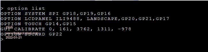

ztoti
Joined: 27/10/2011
Posts: 65
Posted: 02:31pm 20 Jan 2022
Here is:
