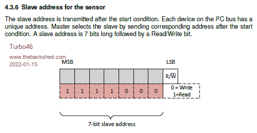

  Quote  7-bit slave address of this device is 1111000b (0x78).
Shouldn't that address be &HF1 (write) Hex not Octal?

From the data sheet the extra bit is the LSB '1' for read.
  Quote  A slave address is 7 bits long followed by a Read/Write bit.

This tells me 7 bit plus LSB. I still read it as &HF1.
Am I mis-reading it somehow?

111 1000 is the address, followed by an extra 0 for write or 1 for read IIRC. 7-bit addressing. Unfortunately 111 10xx is the reserved code to introduce a 10-bit address so that 10-bit units will work on a 7-bit system.

OK, it's a seven bit ADDRESS followed by a '1' bit for 'read'. Does that mean that you DON'T send it '11110001' to issue a read command for that address?
Posts: 9265
Posted: 10:47pm 14 Jan 2022
Yes, you do. You are then supposed to tag on the *actual* 10-bit address.
