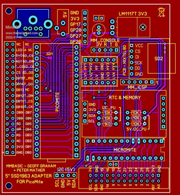

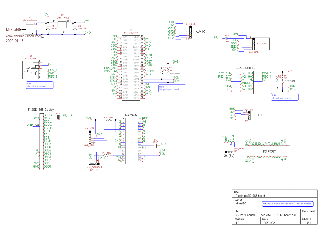

I couldn't resist when Peter asked Grogster for an adapter board...
I omitted the 7" option as I have no mechanical info on that, or any requirement for one. However, I did attempt to make up for the lost IO using a Micromite.

Oh, the 5V I2C interface on this should interface directly with the I2C expander (same connector, same pin order).
The blob connectors for the SD cards are normally both enabled, but you can cut one or the other to disable it if required.
I've tried doing a version for RS485 instead of I2C but it's not working out well. The MAX485 is a 5V chip so I have to use two of the level shifters for it and the track weaving is a pain. I'd like to stick with the same chip really. It might still happen. :)

The only thing that bothers me about the board as it stands is that I'm not sure how much space there is under that RTC module because the battery seems to be there. As you can see, I've put resistors underneath so I'm hoping there's enough space! I've not got one to measure and, of course, there's no mention of that dimension in adverts. I suppose the resistors could go on the bottom of the board if it turns out not to fit.

Using the SSD1963 (in 8-bit mode) a USB keyboard and SD card on the PicoMite there are 6 spare pins. I used two of those for I2C to give me a further 17 from the Micromite, so that's 21 IO in total. I don't consider the Micromite IO to be particularly slow for control purposes - the real world is usually a lot slower than I2C. :) Of the 4 remaining pins 3 are the PicoMite ADC inputs and the Micromite has a further 10, so there are 13 possible analogue inputs, if you felt like going that way.
A PicoMite is now cheaper than an "official" 28-pin MX170 bought from Farnell. The main reason I didn't use one for the I2C expansion module is it's lack of ADC inputs.

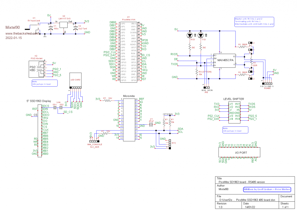

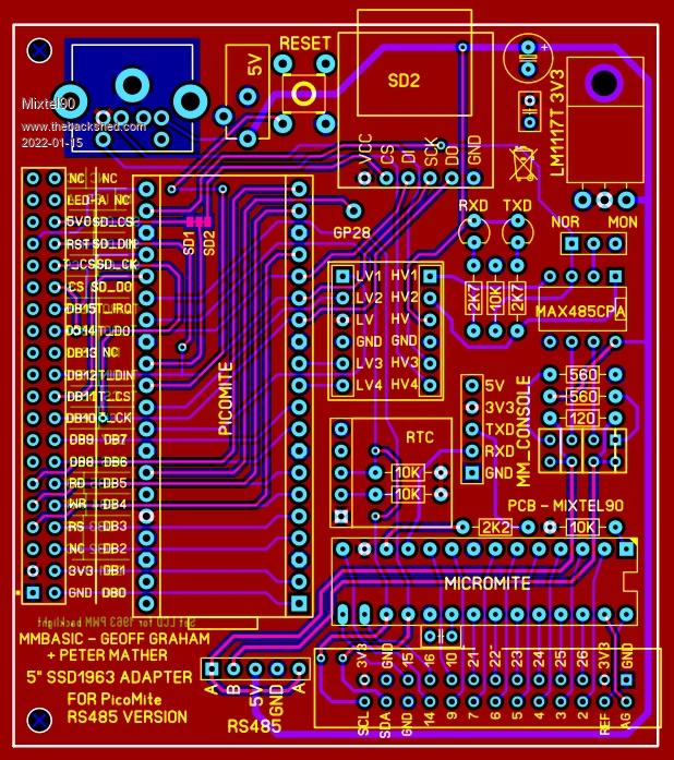

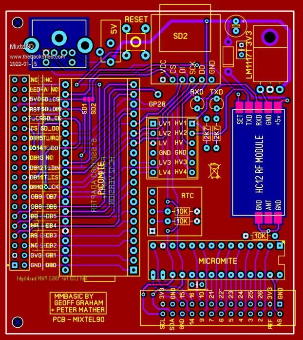

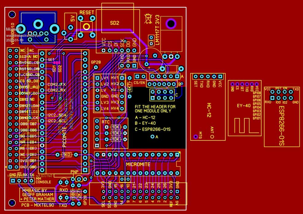

The result of today's playtime:
RS485 version. I had to lose the ICSP connector, but that's hardly a deal breaker as all the signals are on the IO connector. Only GP28 is left now. DE is under user control as the PicoMite doesn't appear to support an automatic mode. I2C at 3V3 is available on the IO connector. The odd arrangement of the RS485 connector allows for easy connection of two twisted pairs or a 4-core flat cable (only for short distances, I think, but might be useful). You can also do A+B+Gnd quite easily. I'm only thinking of a Dupont connector here as a controller should be in a box.
flasherror
Joined: 07/01/2019
Posts: 159
Posted: 12:27am 15 Jan 2022
Nice PCB.
A suggestion: move RS485 connector a little away from the micromite I/O connector, it looks kind of close.
Also, it doesn't look like there are mounting holes on right side (unless the regulator PCB hole is intended to be a mounting hole?) Or maybe this is designed to fit a box? Might need mechanical support if plugging/unplugging things into micromite connector?
I know you attach schematics, but can you upload .zip of them? Some of the text readability is not great considering large images are resized during upload.
Also, what are the SD card and RTC modules?
Edited 2022-01-15 10:31 by flasherror
