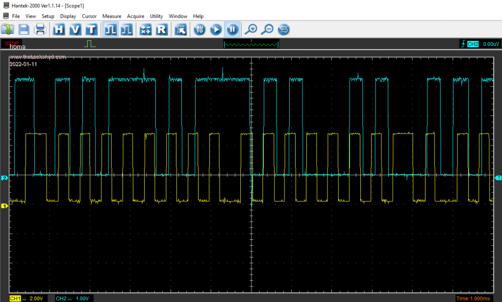

Hello matherp (Peter Mather) and Geoffg (Geoff Graham),
Over the weekend I spent a lot of time with Picomite and learned a lot.
First of all, I dealt with the interrupts.
I wanted to use this to read a Manchester code from an rfid chip of the EM4095.
https://en.wikipedia.org/wiki/Manchester_code
I found out that my interrupt routine is just too long or too slow.
That's why I have already defined fixed timings, in order not to lose even more time through calculations.
I tried to use the following listing:

But in the picture of the oscilloscope you can see that I miss more interrupts on edges of the signal.
And this although the CPUSPEED is set to 250MHz.
Yellow is the Manchester code, blue the wrong bits (sometimes).
