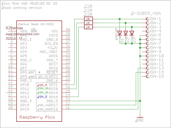

X2themax
Joined: 10/12/2021
Posts: 11
Posted: 05:50pm 16 Jan 2022
Hi there !
First of all, thank you for this great project!
The work that you all put into the Pico Mite is really enormous.
I think it's great to have a 5Euro BASIC interpreter computer with MM-Basic.

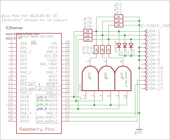

I have already built both versions of the Pico and have a few questions about the VGA version. (...and possibly a few ideas)
I do not understand the current structure with the colour correction.
Why do we need a green LSB and MSB signal ?
Is it right that we have only 8 colours ?

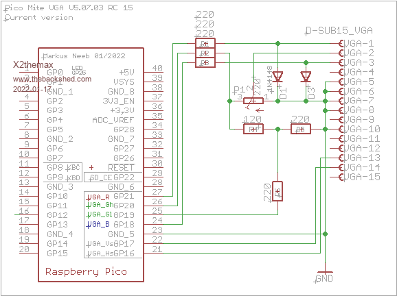

I figured out, that regular 220 ohm resisors and diodes are working very well for an acceptable VGA output with a good white balance:
Now my idea based on an intensity signal like the VDC of a commodore 128 with 16 colours:
In this version 3 AND gates are combining a intensity signal with each colour signal go get 2 shades of the same colour.
What are you thinking about it ?
Best regards form germany and sorry for my poor english language.

Posted: 06:04pm 16 Jan 2022
Markus
The VGA code uses 4-bits for each pixel. I have called this RGB121 and it gives 16 colours if wired correctly. However, each "bit" could be connected in any way you like e.g 16-level greyscale using a 4-bit R2R DAC.
The firmware provides named colours that can be used for all 16 possible outputs and these represent the actual colours if wired RGB121.
   #define WHITE               RGB(255,  255,  255) //0b1111
   #define YELLOW              RGB(255,  255,    0) //0b1110
   #define LILAC               RGB(255,  128,  255) //0b1101
   #define BROWN               RGB(255,  128,    0) //0b1100
   #define FUCHSIA             RGB(255,  64,   255) //0b1011
   #define RUST                RGB(255,  64,     0) //0b1010
   #define MAGENTA             RGB(255,  0,    255) //0b1001
   #define RED                 RGB(255,  0,      0) //0b1000
   #define CYAN                RGB(0,    255,  255) //0b0111
   #define GREEN               RGB(0,    255,    0) //0b0110
   #define CERULEAN            RGB(0,    128,  255) //0b0101
   #define MIDGREEN            RGB(0,    128,    0) //0b0100
   #define COBALT              RGB(0,    64,   255) //0b0011
   #define MYRTLE              RGB(0,    64,     0) //0b0010
   #define BLUE                RGB(0,    0,    255) //0b0001
   #define BLACK               RGB(0,    0,      0) //0b0000
So you can use these as constants in a program and name the constant however you like depending on how you physically connect the pins.
e.g.
DIM integer greyscale[15]
greyscale(0)=rgb(black)
greyscale(1)=rgb(blue)
greyscale(15)=rgb(white)
Posted: 06:52pm 16 Jan 2022
Yes.
Other names would make sense with your idea.

Posted: 05:50pm 17 Jan 2022
Hi Peter,
thank you for your fast response.
Wow cool, that makes sense !
OK I didn't know that and at the same time I
had made a circuit error on my breadboard.
I will try it right away.
Thank you and best regards
Markus

One possible way to map RGIB(1,1,1,1) (untested)
Re-map RGB(1,2,1) VGA to RGIB(1,1,1,1)

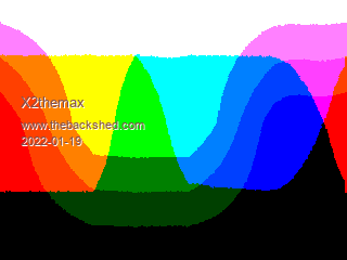

I have loaded this little Image:
RGB-Test.zip
...and it works !
I find it interesting how the image routine quantizes the image.
I guess Phil's idea of a RGIB() command is not bad.

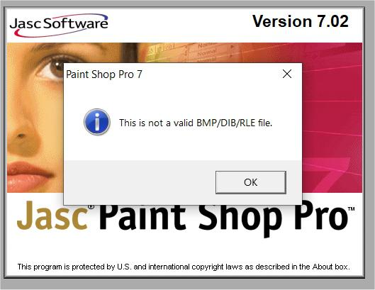

Posted: 04:16pm 18 Jan 2022
  X2themax said  ...and it works !
Great, but why not just show us the image rather than make us download the file, unzip it, and then, when I double-click on it, get "rgb.bmp It appears that we don't support this file format", or when I try to open it with PaintShopPro, get
Posts: 9265
Posted: 04:29pm 18 Jan 2022
Irfanview has no problem in opening either image, even direct from the zip file.

Loading an image directly into the Pico won't give the correct RGIB rendering as the built in image viewer is still decoding it as RGB(1,2,1). It will be necessary to pre process images in a suitable image editor to change the colour palate to make them decode correctly on the Pico despite it not having the correct decoder for RGIB hardware.
I think the re-mapping, in a previous post, of colours only works for graphics and text generated by the Pico not loaded images.
Edit. The mapping in my previous post was done whilst half asleep. Though correct it is poorly thought out.

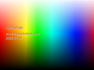

Here is the test image rgb.bmp:
Ok...
XnView opens the picture without any problems.
It is a reguar RGB-Bitmap and the Pico load this picture correct.
If you have any problems I try to post it again.

You should now see the following on the Pico Mite:
Now all 16 colours are displayed.

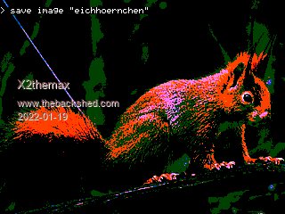

I forgot the following:
If you assign the GPIOs wrong, the two shades of green are reversed and the picture makes no sense!
It should work as above if you coose the right GPIOs.
The Second Image shoult be displayed like this:
I wish you all success !
