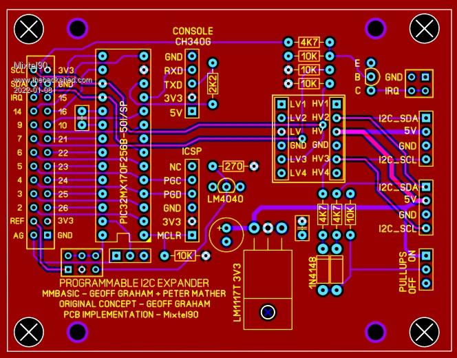

This is designed, with some end panels yet to be sorted out, to fit the 90x70x28 box.
I2C connection is looped through so that modules can be cascaded (but addresses will have to be set in firmware).
Supply and I2C is at 5V and the SCL and SDA lines are on the outside to reduce cable capacitance. This should allow operation over reasonable distances using ordinary 4-core flat cable. Powering at 5V also allows each board to have its own 3V3 regulator, taking the load off the SMPS on a PicoMite. Note that level shifting is needed if this board is connected to I2C lines that can't handle 5V. However, the 3V3 side I2C lines are available on the IO connector, the pullups are fixed on though.
An active high IRQ signal is available on the connector, which drives a cascadable open collector signal back to the host. No pullup is included as that will depend on the host.
Pullups on each board can be enabled/disabled from outside the case.
Links allow the analogue supply to be external, 3V3 or a 3V reference and the analogue ground can be linked to GND internally.
Any further ideas?

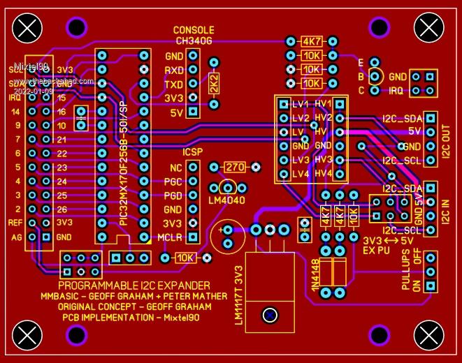

This version *should* be able to be driven directly by a 3V3 system. I2C IN has links to allow either normal 5V connection or spare inputs on the voltage shifter. Outputs from the shifter are paralleled up with the other 5V signals. There are no pullups when a 3V3 system is used as that would apply 3V3 back down the lines to a system that may be powered down. I don't know the circuit of the level shifter so I'm not *certain* about this. Obviously a 5V supply is still required to feed the 5V I2C to the next board.

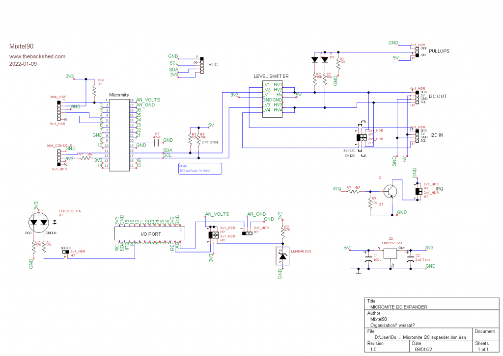

Found the circuit and it's what I expected. There will be 3V3 on the I2C pins via 10k resistors even if the host is off. Oh well, tough. :)  It's probably powering the I2C board(s) anyway so they are probably off too.

  Mixtel90 said  Supply and I2C is at 5V and the SCL and SDA lines are on the outside to reduce cable capacitance. This should allow operation over reasonable distances using ordinary 4-core flat cable. Powering at 5V also allows each board to have its own 3V3 regulator, taking the load off the SMPS on a PicoMite.
Funny, I've always thought that the I2C bus capacitance it is not taken in consideration in regards to the cross-talk (the transmission of signals to the adjacent line, through the inter-line capacitance, due to long parallel runs), but instead it have to do with the open-drain nature (as opposed to push-pull) of the bus: being the high level not driven the rise time of the signal increases and the sharpness of  the square waves decays being the edges and corners "rounded" thus introducing errors in the bit sampling of the signal.
But, anyway the project seems interesting.
May I only suggest a P82B715 or a P82B96 in place of your level shifter with a 100nF and a 22uF 25V capacitors on the external bus power supply. These buffers allows up to 12/15V bus levels.
And I will reserve the places also for internal-I2C bus pullups on the board. You can always leave them unpopulated.
Edited 2022-01-09 05:53 by dMajo

Posts: 9095
Posted: 08:32pm 08 Jan 2022
Thanks for your suggestion. I think I'll stay with the level shifter for the moment though, purely on a cost basis as they are very cheap and easy to find. However, I might consider doing another "long range" version later. That would make an interesting project.
You can get better performance on I2C using suitably fast constant current sources for the pullups, I believe, but I don't fancy going down that route at the moment either. It's something that could be experimented with.
Cross talk between SCL and SDA can be a problem as the clock corrupts the data. It's better to separate them. Cable capacitance is the ultimate distance limiter, so slower speeds work over longer lines and low-capacitance cable is good. You can apparently twist SDA and SCL with their own ground wires or one with ground and the other with supply if the cable has suitably low capacitance.
This isn't long range stuff. RS485 is *far* better. I just haven't got round to looking at that yet. :) I was just looking for something quick & dirty to extend the IO of a PicoMite driving a SSD1963 parallel display and got a little sidetracked...

Current circuit (it's probably about right):

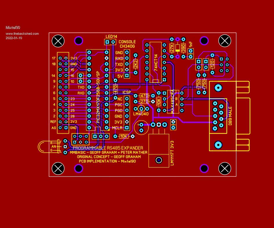

The Micromite has a COM1 DE output that goes low on send to use with the direction input on a 485 transceiver - pity it's inverted...
Oh yeah... I remember seeing that...
I can do you a pcb for a 485 version if you want to have a play. You could link two together. :)  You'd have to sort out the firmware for both ends though 'cos I'm having far too much fum playing with pcb design. :)
I'd suggest a simplified firmware though. It doesn't need to be very flexible and could use the same SSETPIN, SPIN and SPIN() approach to keep things simple for the user. After all, it's only controlling a Micromite.

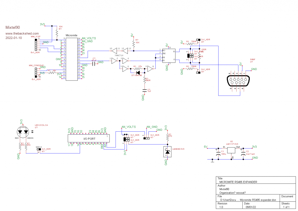

Here's an RS485 half-duplex version anyway. I *think* it might work. It has the same number of usable IO pins, but the I2C pins 17/18 replace 21/22 which are needed for COM1. Can't do a loopthrough if I use a DB9 as the box isn't big enough. :)
And just for completeness, here's the circuit:
