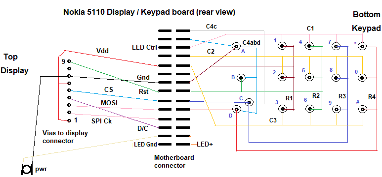

I have a couple of Nokia 5110 phones in the junk box that may have usable displays but don't know how the 9 pads connect to the pins on the carrier board version.
Does anyone have a circuit for the carrier board?

Hi Phil, thanks for the response. I'm looking for PICO examples and it looks like Fred has his working, so would be my best shot at it.
With the old Nokias you mention, do you mean the red eBay modules or the phone pcb itself? The red module I have has 8 pins (1 Rst, CE, DC, DIN, CLK, VCC, LED, GND). I can't help with the phone's pcb, unfortunately.

  Quote  do you mean the red eBay modules or the phone pcb itself?
The phone  itself.
  Quote  The red module I have has 8 pins (1 Rst, CE, DC, DIN, CLK, VCC, LED, GND).
I need to map those 8 pins to the 9 pads on the LCD.
If I can identify Vcc and Gnd I could use trial and error for the others without destroying it.

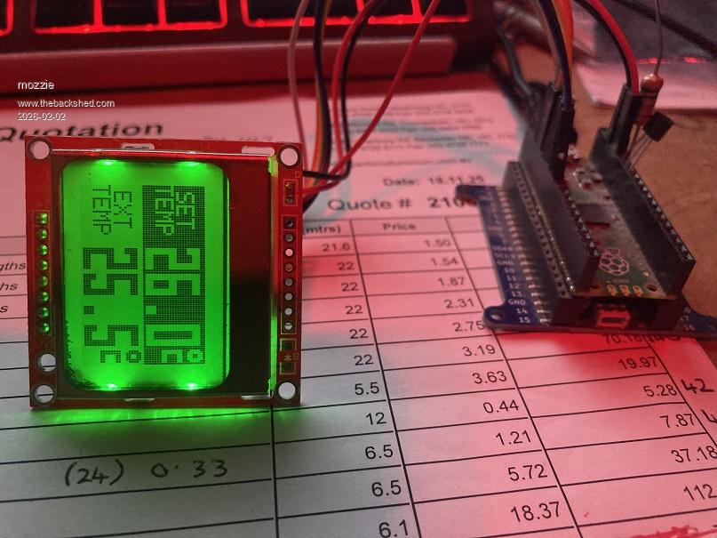

G'day WJSMarine,
These displays are great for low power and daylight readable applications.
I use the following connections and settings:
SCLK=GP2, DIN(MOSI)=GP3, D/C=GP5, RES=GP6, SCE=GP7
OPTION SYSTEM SPI GP2,GP3,GP4
OPTION LCDPANEL N5110,L,GP5,GP6,GP7
And this to test the display with the temp from a TMP36 sensor on GP28
' Program to display temps on N5110 Display
' TMP36 sensor on GP28
' Deg C symbol is "(" in font 9
Option vcc 3.23
Option default integer
SetPin gp28,ain
CLS
 Settext
 For i = 1 To 5
   Settemp
   Pause 1000
 Next
 Box 0,0,28,24,,1,1
 Text 3,4,"SET",,7,1,0,1
 Text 0,12,"TEMP",,7,1,0,1
 For i = 1 To 6
   fgc=1:bgc=0
   If i Mod 2 = 0 Then fgc=0:bgc=1
   Text 28,0,Str$(20+i)+".0(",,9,1,fgc,bgc
   settemp
 Pause 1000
 Next
Loop while inkey$=""
Sub Settext
 Box 0,0,28,24,,0,0
 Text 3,4,"CAB",,7,1
 Text 3,52,"EXT",,7,1
 Text 3,28,"EXT",,7,1
 Text 0,36,"TEMP",,7,1
 Text 28,0,"25.4(",,9,1
'  Text 28,24,"41.2(",,9,1
Sub Settemp
 Ctmp$=Str$(100*(Pin(gp28)-0.5),2,1)+"("
 Text 28,24,Ctmp$,,9,1
End

And it looks like this when you change the backlight LEDS to green:
This font is designed to be easy for a blind old fart like me to read
Lyle.

The units here have a RED PCB and there are a few issues with these LCD's:
The PCB is too thin and warps away from the zebra strip, losing connection.
The PCB is not gold plated and the connections for the zebra strip will tarnish, losing connection.
The displays are either second hand / NOS or a second, I have a couple with odd pixels around the display area always black. (See previous post)
A few have been dead on arrival but repairable, occasionally they cannot be revived
Good luck
Lyle.
