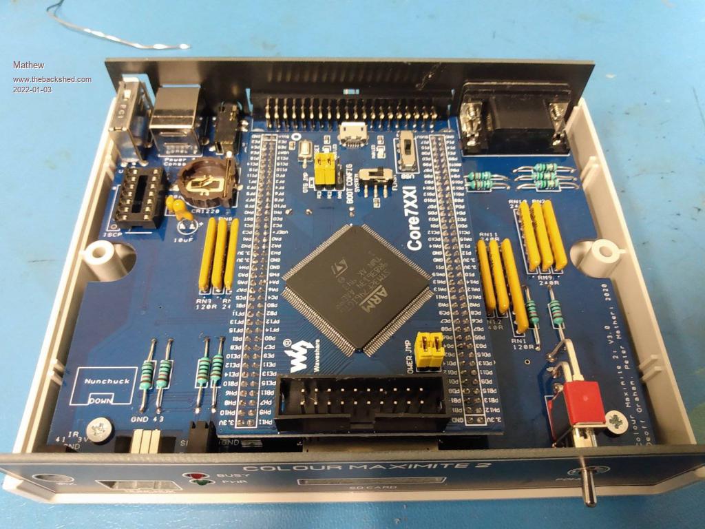

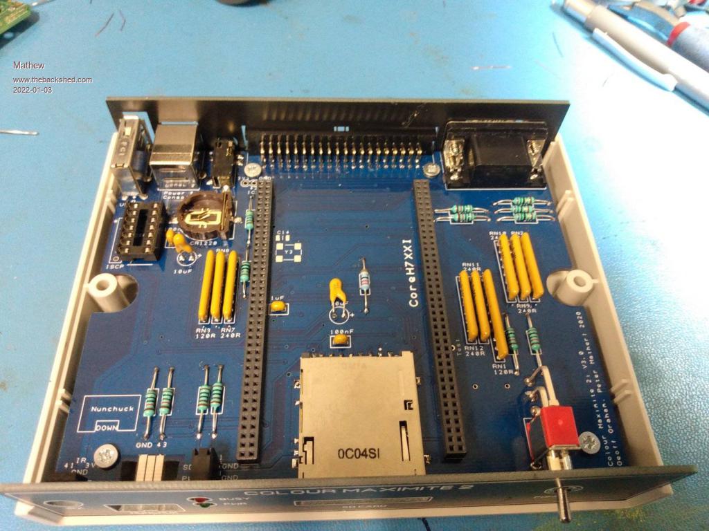

I was given a kit to build a Colour Maximite 2 and been having fun, but I seen to be stuck.
It is a v3 motherboard by Geoff Graham and Peter Mather, which uses resistor arrays. The kit came with 220 ohm arrays instead of 240 ohm ones, so I ordered some 240 ohm ones from eBay.
I am an experienced solderer, so I think I soldered everything correctly. Here are some pictures. It's in this state right now except I also populated the 14 point in socket in the top left.
I uploaded the 5.07 firmware I found online (with jumpers removed like the instruction said), put the jumpers back on, plugged the power and monitor in and turned it on. The power light comes on, but there is no output to the monitor.
Help would be appreciated.

You need a battery fitted and all the jumpers removed from the waveshare module. Alternatively, no battery and just the VBAT jumper.

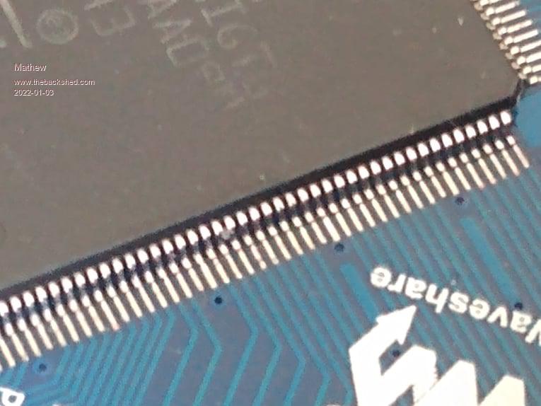

Looking at the waveshare, I notice what looks like a short between two legs of the main chip. This has me worried.
Posts: 9265
Posted: 03:35pm 02 Jan 2022
Will that bit of something shift with the aid of a pin or something? From your photo it doesn't look like solder.

For running
Boot Switch to flash
power switch to 5Vin
all jumpers removed except VBat if no battery fitted.
This is all in the constructors pack on Geoff's site

I rather hesitate to bring this up, but do the resistor networks you got have identical pinout to the 220R ones supplied? There are variations between packs.

As Mick says, you did get the correct resistor packs? They are not the ones with a common at one end but just individual resistors with each consecutive pair of pins connected to one resistor

I am concerned about the solder short on the wave share, you need to remove that, use solder wick and a hot iron but do not over heat the joints, if not moving, which it should. You could revert to a sharp scalpel but solder wick works well especially with some added flux.
Another thing to be aware of is there are two types of resistor packs..
A type which have all resistors commoned to one pin (marked with a dot) and
B type which are individual resistors. Always have even number of pins.
If you replaced any resistor packs ensure you used the correct ones. Looking at the schematic they should be B type (at least for 240R ones) as there is no common point for the 240R resistors.
