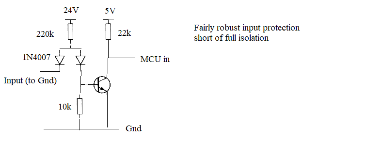

Posted: 07:59am 03 Jan 2022
The systems I worked on didn't bother with opto-isolation or galvanic isolation on runs where lightning might be a problem. They don't give any protection at all at 36kV, never mind lightning so there's no point in bothering. :) (I used to love playing with the 36kV pressure tester at work!) It was multiple sets of fuses and transzorbs to a solid protective earth bar before you got out of the building. Same at the other end. Nothing protects against a direct strike on the cable. Not even the walls of the building sometimes.
The main reason for isolation is to prevent accidental operation of something due to common supply wiring being not what it says. If you can guarantee a common return rail (which should only be grounded at one point if at all) then there's no real need for isolation. Station alarm batteries sometimes float both ends of the battery and use an earth fault detection relay to sense if either side gets earthed. You'll need isolation if you are working with both one of those and an earthed supply.
Another reason is for intrinsically safe appications, where the maximum available power into the protected area is restricted to less than the point where it could cause an explosion or fire. That might mean using galvanic isolation, particularly for supplies which are typically limited to 2W maximum.
Cows sometimes die in fields near electricity pylons. If the pylon gets a direct strike the immense ground current causes a huge voltage drop through the ground. The distance between a cow's legs is sufficient for a portion of that voltage to stop its heart.
