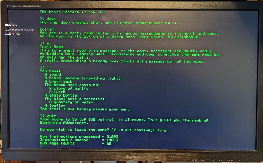

  matherp said  zmim tested
Neat, though at ~150 instructions per second it will be barely playable. IIRC on the CMM2 it achieves in excess of 1000 instructions per second.
Given the output it looks like you are running the CMM1 version ? This was slow because it had to use a virtual memory implementation.
Does the transpiled CMM2 version not work https://github.com/thwill1000/cmm2-zmim/blob/master/zmim.bas ?
I really hope I can find time to revisit Z-MIM some time soon as it would benefit from being updated to use some of the more recent MMBasic features.
Edited 2022-01-02 10:27 by thwill
