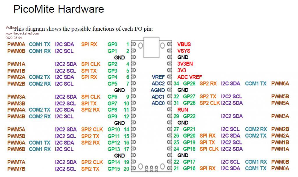

Posts: 6068
Posted: 02:03pm 03 Mar 2022
According to the manual, when you declare SYSTEM SPI, this SPI bus is used for Touch, ILI9341 and SD card combined.
These devices share clock, MISO and MOSI pins, but have individual CS and INT pins (and D/C for te ILI9341).
In that case:
ILI9341 -------------
OPTION LCDPANEL ILI9341, OR, DC, RESET, CS
The backlight PWM channel driving the LED, is not part of the OPTION LCDPANEL decaration. It must be declared in a separate line. (GP22 must be removed).
GP22 is a genuine PWM pin (PWM3A) so the wiring can be done. But declaration must be separate..

Posts: 6068
Posted: 03:42pm 03 Mar 2022
Hi Bill,
Backlight as an additional paramter in the OPTION LCDPANEL... Never too old to learn..... Thanks. I didn't know that. Must have missed it in Geoff's user manual.
According to the PicoMite user manual, GP22 is PWM3A. I think you looked at PIN22. PIN22 is not GP22.
I think T_out must be connected to GP16 (SPI_RX or also called MISO pin) to be able to read the coordinates from the Touch controller chip over the system SPI bus.
Edited 2022-03-04 01:45 by Volhout
Posts: 9095
Posted: 04:01pm 03 Mar 2022
OPTION SYSTEM SPI GP18, GP19, GP16 'clk, mosi, miso
OPTION LCDPANEL ILI9341, L, GP21, GP20, GP17, GP22 'or, dc, rst, cs, bl
OPTION TOUCH GP15, GP14 'cs, irq
I think the above should work fine, lew. GP22 is PWM3A so I don't think PWM3B can be used for PWM. You do need T_OUT if you are going to use touch.
The backlight control was added later and isn't really in the best place in the manual IMHO. It would have needed rather a lot of messing about to put it elsewhere though, I think, as it only applies to a limited number of displays.

Posts: 3368
Posted: 11:16pm 03 Mar 2022
"So I not need T_out connected on the ILI9341?"
T_out must go to GP16 along with SDO as noted by Volhout.
