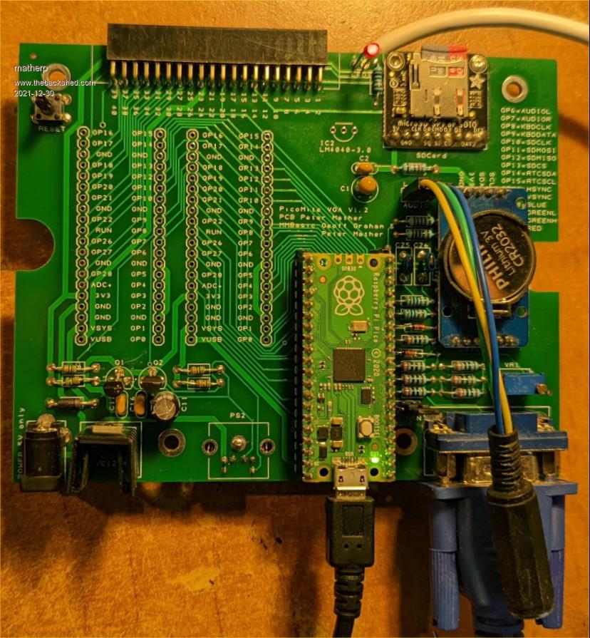

Attached in the ZIP are the DesignSpark design files, the BOM, a printable schematic and a zip containing the gerbers.
NOTES:
Use a jumper on the 3V3_SEL header to disable the PicoMite power supply if you want to use the onboard linear supply. With the header in place you can power the board through the 2.1mm power connector or with the USB connection to the Pico. Both supplies have an in-line diode so it doesn't even matter if both are connected.
The MODE header selects between RGB/mid intensity green mono if in the left position and full intensity green mono in the right position. the header could be connected to a panel mount changeover switch if required
The mosfet footprints are for a BST72A which is the device tested. If using another n-channel enhancement mosfet be sure to match the source, gate and drive to the silkscreening. Any mosfet must meet the requirements specified in AN97055
The audio header can be connected to a panel mount 3.5mm audio socket
The SDcard module can be mounted on a header or direct soldered to the board as in the picture
Solder header pins into the 2 extra Pico pinouts to mount Pico shields direct on the PCB
The RTC headers support both the major types of DS3231 modules available. I prefer this version as it has a larger and widely available replaceable battery

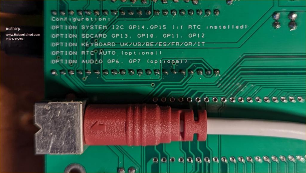

All option configuration is specified on the silkscreening on the bottom of the PCB
Many components are optional - see the BOM for details
If the LM4040-3.0 is fitted ensure that you include OPTION VCC 3.0 in any programs using the ADC
Adjust VR1 to get the best white balance when in colour mode
I'll post dxf files for end panels for the case at a later date
FINALLY enjoy the complete b....ks I made of the PS2 connector in my prototype

Thank you, Peter. Now I know that I'm not alone when I totally screw something up and it makes me feel better about it. :) Don't feel too bad about this. One of my current projects is a Nascom-4 (it simulates an expanded Nascom-2 using a FPGA). The designer of the board also crossed over the PS/2 connections so now it's mounted on the bottom. :)
I currently have 5 of the mini PCBs on the slow boat from China - all with messed up connections to the PS/2 skt. It's a track hack to fix that though.

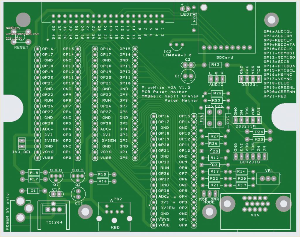

1. the 40-way connector (J3 on your schematic), does each row of pins on the physical connector correspond to one side of the pico? this is how it is depicted on the schematic, but NOT how the pins are numbered on the PCB.
2. can the RTC I2C bus be shared with other I2C devices that the user attaches?
rob   :-)
Posts: 12071
Posted: 02:02pm 30 Dec 2021
  Quote  does each row of pins on the physical connector correspond to one side of the pico?
No the numbering on the silkscreen should be correct and relates to the Pico as a standard DIL chip with GP0 as pin1 and VBUS as pin 40

so the layout (looking into the connector from the front) is something like the below?
   (1)          (2)
   GP0   x  x   GP1
   GND   x  x   GP2
   GP3   x  x   GP4
   GP5   x  x   GND
   GP6   x  x   GP7
   GP8   x  x   GP9
   GND   x  x   GP10
  GP11   x  x   GP12
  GP13   x  x   GND
  GP14   x  x   GP15
  GP16   x  x   GP17
   GND   x  x   GP18
  GP19   x  x   GP20
  GP21   x  x   GND
  GP22   x  x   nRST
  GP26   x  x   GP27
   GND   x  x   GP28
ADCREF   x  x   3v3
 3v3EN   x  x   GND
  VSYS   x  x   VUSB
  (39)          (40)
rob   :-)
Edited 2021-12-31 00:44 by robert.rozee
Posts: 12071
Posted: 02:59pm 30 Dec 2021
  Quote  so the layout (looking into the connector from the front) is something like the below?
Exactly so. We can include that as a picture in the manual when written

I'm struggling to understand the above - isn't it wrong?
Am I mixing up the CPU pinout and whatever J3 is?
Also, looking at the schematic, VGA looks to be shown as 17 pins but isn't it a DB15?
(or some such name)
Edited 2022-03-22 03:38 by JohnS
Posts: 12071
Posted: 05:44pm 21 Mar 2022
The pin numbers on the connector are exactly the same as the Pico BUT the layout of the connector is completely different. See the pic of the board at the top of the thread which shows the pin numbers on the connector. I could have used the Pico layout but then everyone would have complained the the pin numbering on the connector was non-standard (can't win on this one )
