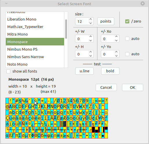

- vastly improved font selection, including ability to tweak certain parameters. see new font dialog:

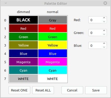

- worth mentioning also is the palette editor, added in a couple of months back:

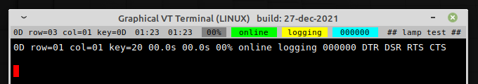

Very nice! I wasn't able to break it. I did notice, however, that it doesn't respect Windows display scale parameter. I have a 4K display but have the text scale set to 175%. GFXTerm still displays status line text at 100% (see below)

  toml_12953 said  I wasn't able to break it. I did notice, however, that it doesn't respect Windows display scale parameter. I have a 4K display but have the text scale set to 175%. GFXTerm still displays status line text at 100%
am really pleased, as i've done far less testing on windows - the only usable windows 'machine' i have is a winXP virtual machine running in Virtual Box.
as much as possible, scaling is deliberately disabled in GFXterm. this is because the whole 80x24 character grid layout idea behind the 'terminal window' is based on simple pixel calculations, which scaling completely messes up. as a result, the status line is limited to 640 pixels wide, which corresponds to the 80 columns of 8-pixels each (the minimum character cell width allowed). changing this limit would require a major rework of the underlying code.

Increasing the font size increases the size of the window automatically. Would it be possible to print the status line in the same font and size as the other text? The overall window size would remain 80x24 + 1 for the status line.
Posted: 02:41pm 28 Dec 2021
  toml_12953 said  Would it be possible to print the status line in the same font and size as the other text? The overall window size would remain 80x24 + 1 for the status line
hmmm... i hadn't thought of that
a quick check reveals:
so it is doable. the status line font is actually 7 pixels wide (i used 8pt 'Monospace' for Linux, 8pt 'Courier New' for Windows), which gives that little bit extra spacing you see between labels on the status line. 640/7 = approx 90.
unfortunately font sizes are defined by height (either points or pixels), with the width being whatever you are lucky enough to get on the day. this makes some sense, as few fonts are fixed-pitch. but it would mean that i would need to do some on-the-fly checks to make sure that none of the labels were too wide... i shall have to think more about this
