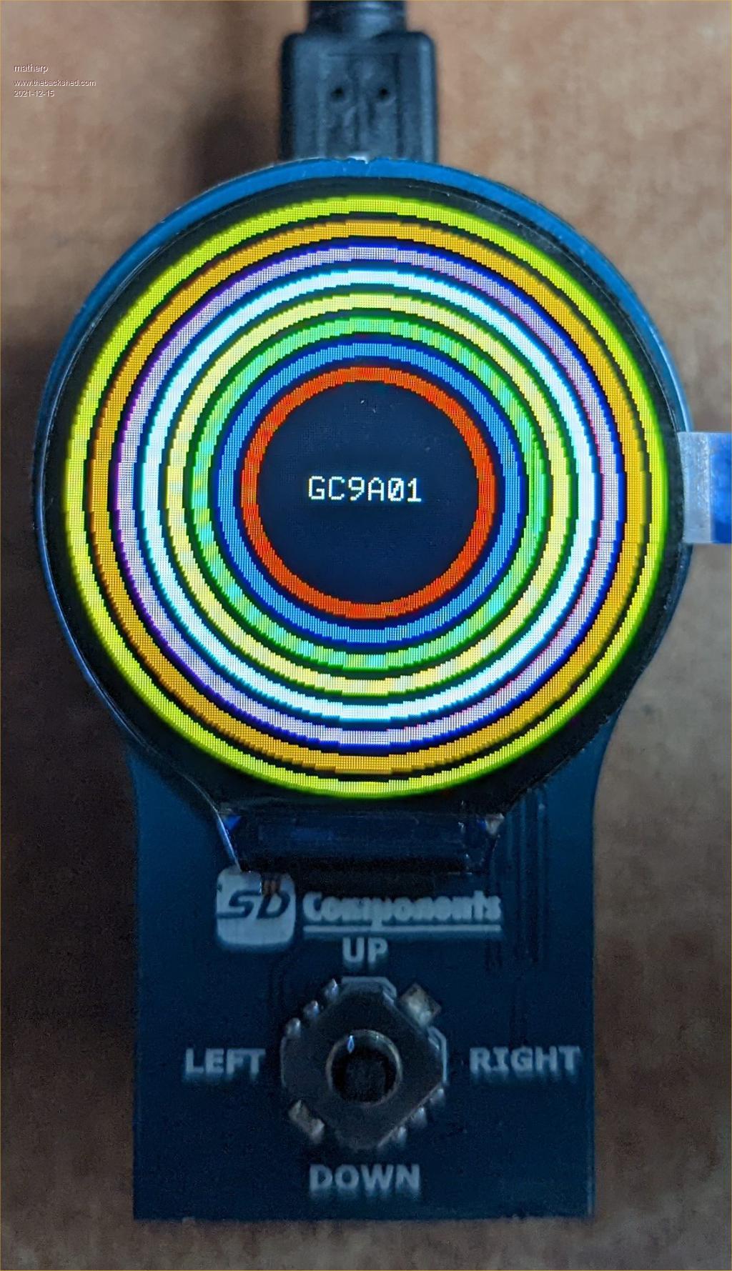

Lewis recently sent me a 1.28" Round LCD HAT for Raspberry Pi Pico with a request to create a driver for it. This I have done and rather than add it to my huge box of unused displays we have agreed to send the display (not the cheapest) to the person who comes up with the most interesting idea for using it, with of course a commitment to building their idea.
Details of the display are in the link. The PCB is 37mm at its widest point and 58mm tall and of course includes the 5 position joystick switch. It plugs directly onto a standard Pico
Please post ideas on this thread and Lewis and I will judge the best with a Christmas deadline. Extra points will be given to anyone who models and demonstrates their idea on any other Pico display.
