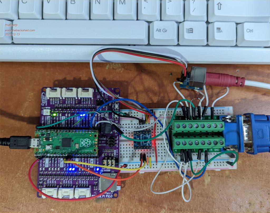

Please find attached the first beta for the PicoMite VGA Edition.
PicoMiteVGAV5.07.01b0.zip
Special thanks to Miroslav Nemecek for the code used as the basis of the VGA driver. This runs exclusively on the second processor and has little of no impact on MMbasic performance.
The only compromise is that the display has to be blanked when writing to flash as this can only happen with interrupts disabled. How fast the image returns depends on how fast your monitor re-establishes lock.
This happens when exiting edit, exiting autosave, changing options, using VAR SAVE or using FLASH commands that write to flash. Otherwise the image seems very stable and clear.
The PicoMite VGA Edition takes the existing Picomite code and makes the following changes:
Program size reduced to 64Kbyte
GUI and Touch functions removed
PIO0 no longer available to MMBasic
Support for all LCD displays removed
OPTION CPU SPEED removed
GP16, GP17, GP22 not available to MMBasic
Support for a PS2 Keyboard added
OPTION KEYBOARD NO_KEYBOARD/US/FR/GR/IT/BE/UK/ES
Support for a 640x480 60Hz monochrome VGA display added and automatically configured
OPTION CPU TURBO ON/OFF (126MHz or 252MHz)
OPTION DEFAULT FONT fnt [, scale] 'e.g. OPTION DEFAULT FONT 7
All other PicoMite functionality should be as per the PicoMite manual
Wiring:
VGA
GP16 connect to VGA socket pin 13
GP17 connect to VGA socket pin 14
GP22 connect to VGA Socket 1, 2, or 3 via 220ohm resistor
Connect 1n4148 diode anode to VGA socket pin 1,2,or 3. Connect 1N4148 cathode (bar end) to GND
Connect GND to VGA socket pins 5,6,7,8,10
PS2 Keyboard
IMPORTANT
use level conversion between the Pico pins and the PS2 socket or run the keyboard at 3.3V
Connect GP8 to PS2 socket CLOCK pin via level converter (tested with this one)
Connect GP9 to PS2 socket DATA pin via level converter
Connect VBUS to PS2 socket +5V
Connect GND to PS2 socket GND
Enable the PS2 Keyboard with OPTION KEYBOARD
IMPORTANT
Clear the Pico flash with Clear_flash .zip before loading this firmware and if subsequently returning to the normal PicoMite firmware

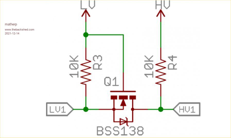

Posted: 08:53am 14 Dec 2021
Much better to do the level change properly
a cheap mosfet and two resistors. i.e. the incremental component count is two resistors and two mosfet

Posted: 09:31am 14 Dec 2021
Both perfectly valid, but a proper level shifter is overkill for a PS/2 keyboard. :) All you really need are two zeners - the pullups will limit the current. Neither side is supposed to ever apply their supply voltage to either pin - from a hardware perspective it's I2C where the keyboard is the master. Any pullups built into the keyboard will tend to be between 1k and 10k so there's not a lot of zener current.
