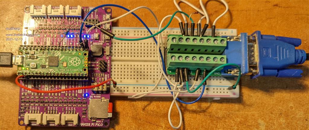

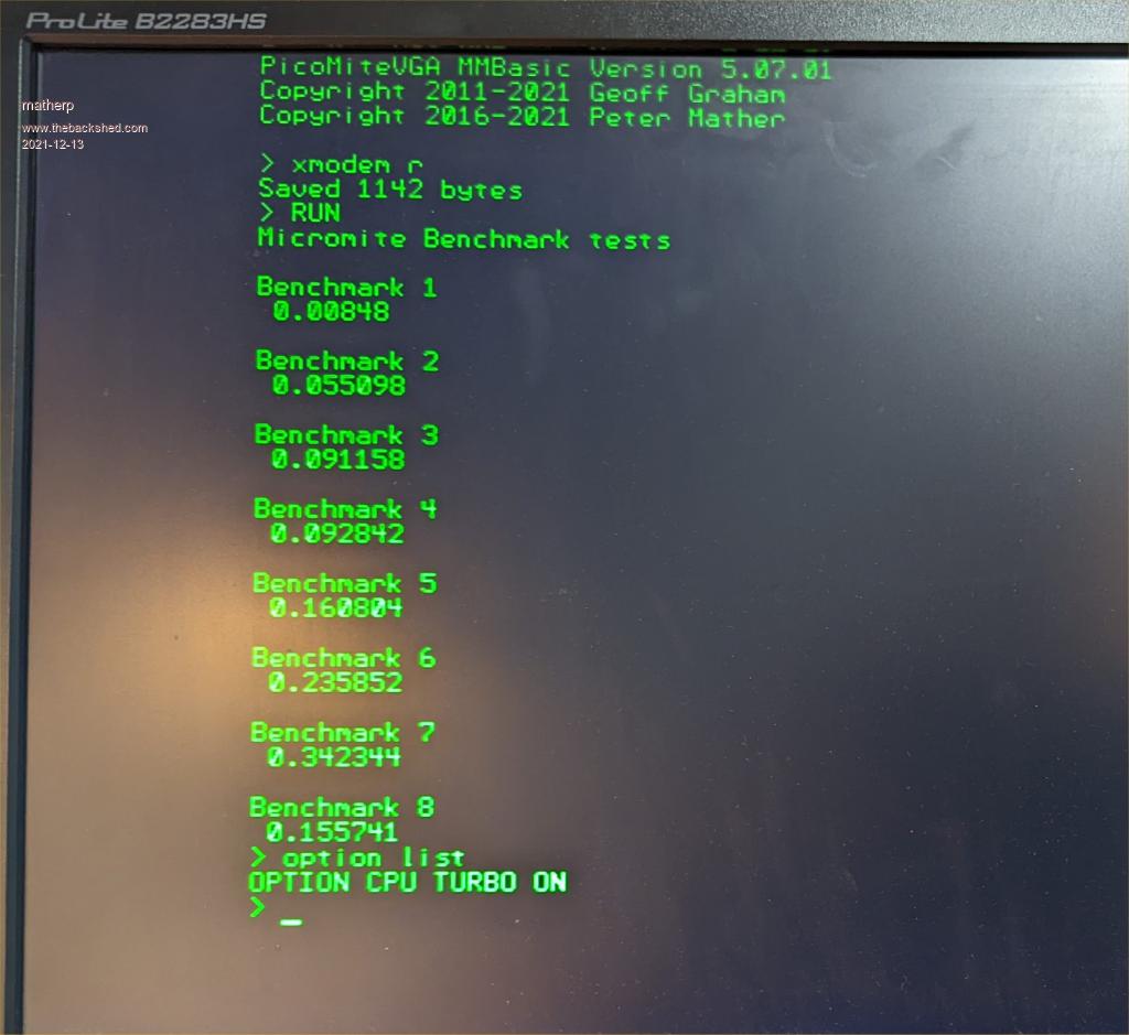

Posted: 07:56am 13 Dec 2021
  Quote  ...is there already somewhere a version to try out???
Just tidying it up and getting PS2 keyboard working then will release a version.
This will be a VGA only version - no support for any other displays and no GUI/TOUCH support (makes no sense on a monochrome display).
CPU runs at either 126MHZ (normal) or 252MHX (turbo). Also PIO0 is not available for use.
Other than that it will have all the other PicoMite functionality.
The only compromise is that the display has to be blanked when writing to flash as this can only happen with interrupts disabled. How fast the image returns depends on how fast your monitor re-establishes lock.
This happens when exiting edit, exiting autosave, changing options, using VAR SAVE or using FLASH commands that write to flash. Otherwise the mage seems very stable and clear.

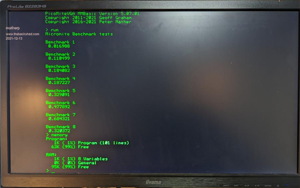

Hi Peter,
Looks you are running native 640x480 resolution, not the QVGA 320x240.
So you modified for monochrome, and clocked at 252MHz, and reserved 38k for video memory ?
Leaving an impressive 210k RAM for basic ? (effective 65k editor, 65k variables, 65k program ?)
