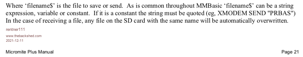

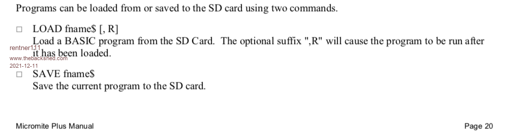

I think then the error message is not correct either? Shouldn't a "syntax error" be displayed? Whereby it works with "SAVE Fname $, and the documentation says the following in 2 places:

Your second quote is from the XMODEM description.
You seem to have taken 'common' to mean 'in every instance' rather than 'very often'
LOAD is a special case because it is meant to be used on the command line, not in a program.
