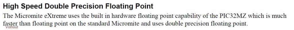

Hi Tom,
From the user manuals....
On the Maximite (CMM1) the floating point numbers are single precision, as are the integers
On the Micromite (MM2, MMplus) the floating point numbers are single precision, the integers are 64 bit.
On the Micromite Extreme double precision floating point numbers are introduced.
I think since then both integers and floats are 64 bit.
Posted: 11:16am 02 Dec 2021
Thankyou for taking the time @Volhout and not telling me to RTFM.
Captain, if you are watching then (unless I am confusing myself) I believe this confirms my answer to your question: https://www.thebackshed.com/forum/ViewTopic.php?FID=16&TID=14328&LastEntry=Y#178348#178344.
On the original platform you asked about (32MX17 Mk2) MMBasic has 32-bit FLOATs and thus needs separate CSUBs for swapping INTEGERs and FLOATs, but the VGAmite has 64-bit FLOATs so can use the same CSUB for both.
