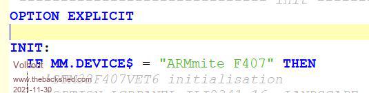

1/ The editor adds 3 lines at top of the file:
'MMEDIT!!! Basic Version = Micromite_5.05.01
'MMEDIT!!! Port = COM13:38400:10,300
'MMEDIT!!! Device = Micromite_5.05.01
Do these lines get copied over to the picomite ? The flash system in the picomite shows the top line of the basic program in each slot in flash with "FLASH LIST". Then all programs are called 'MMEDIT!!! Basic Version = Micromite_5.05.01.
2/ A labels called "INIT:" is seen as a token (command/function) where this function correctly in the MMBasic on the MMites involved.
3/ Nice to have: it would be nice if functions/subs names could also get a color. But that would mean you have to scan the file (and includes) and create a list of named subs/functions.

Thanks for the report.
The lines you are seeing at the start of the program are left over from the earlier version of MMEdit where the com port etc were saved with the code.
You can ignore them or delete once you have changed over to V5
There are some places where they get removed but not always.
I will remove INIT from the keyword list.

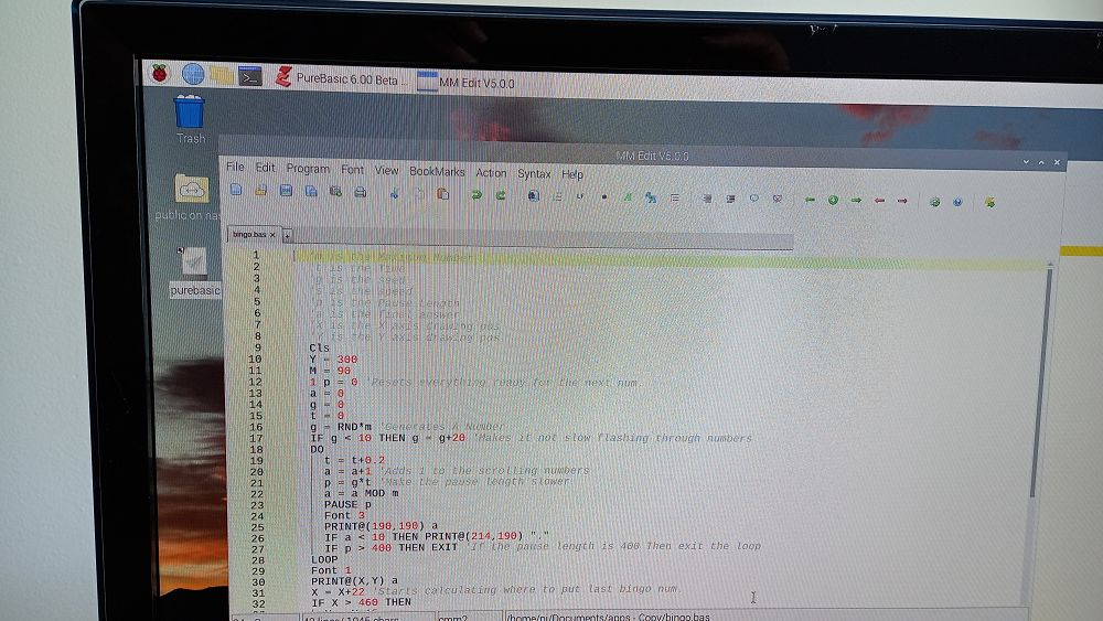

Posted: 06:56am 08 Dec 2021
MMEdit working on my RPi.
Still a lot of work to do but I am pleased to have got this far
The ZIP contains a .gz file with the required files.
Extract it to any convenient location and play.
It works on the latest Raspberry OS. Not sure if you will need any dependencies or if it works on older versions of the OS.

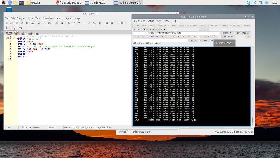

The first line of the BAS file is
'target port\ttyACM0:115200 s\picomite
Load a file,
put an appropriate 'target line in and
click on the lightning bolt icon (far right of toolbar)
It should open the MMCC and connect and load the BAS file.
An alternative method is to open MMCC and configure a port.
Connect to the 'mite,
in MMEdit or any other editor,
'select all' and drag it onto the terminal window of MMCC.
