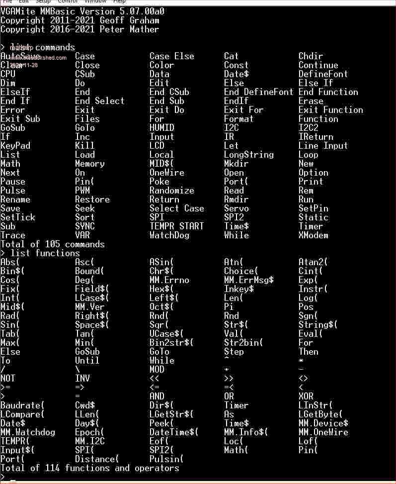

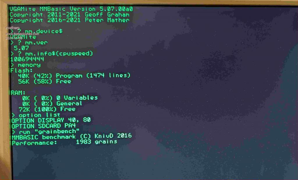

Posted: 04:46pm 27 Nov 2021
Please find attached the first alpha release of the VGAMite based on the STM32F411 "Blackpill"
411VGAV5.07.00a0.zip
This supports a full implmentation of MMBasic and the usual peripherals and I/O
Current status is as follows:
VGA output and MMBasic operation including editor - tested
VGA support is 640x480 @ 60Hz using a 25.175MHz pixel clock
Font is currently 8x12 pixels giving 80 characters across with 40 lines
SDcard support - tested
I2C and I2C2 - tested
SPI and SPI2 - tested (NB: SPI2 not available if SDcard enabled)
PS2 keyboard - tested
XModem support including transfer to and from SDcard - tested
COM1 and COM2 - tested
TEMPR command and function - tested
SETPIN DIN, DOUT, AIN - tested but not every pin
SETPIN FIN, CIN, PER - implemented but untested
IR, PULSE, PULSEIN, KEYPAD, LCD, DISTANCE, PORT, HUMID - implemented but untested
MATH routines as per CMM2 - implemented but untested
Graphics commands, variable font support - to be implemented
Flash support, GPS support and background ADC support TBD
WS2812 support cannot be implemented due to timing conflicts with the VGA output
NB: THis is an alpha release. Although functionality has been tested where stated it has not been regression tested as new functionality was added so expect bugs

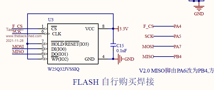

Posted: 06:11am 28 Nov 2021
  disco4now said
  matherp said  SPI and SPI2 - tested (NB: SPI2 not available if SDcard enabled)
It looks like the onboard Flash chip is wired to what is now SPI2. Is there any merit to swapping the pins for SPI and SPI2 so that the onboard Flash could be used from MMBasic when the SDCard is enabled.
The onboard flash appears to use PB4 for MISO just to make life interesting.
I haven't tried to connect a SDcard yet so don't know if having the flash onboard will be a problem.
This is the V2 circuit.
There is a reference to PA6 but nothing in English...
I will have to do some tracing the hard way.
Edit: I did an on line translation:
'MISO pin is changed from PA6 to PB4, which is convenient for STM32F411 users to connect TF card and FLASH at the same time'
Edited 2021-11-28 16:17 by TassyJim

Posted: 07:30am 28 Nov 2021
Strange. Using a different MISO pin would certainly prevent a data clash on read if both were enabled together, but writes could probably corrupt either the SD or the flash or both. I could understand having different /CS pins - that makes sense to me. :)
From Zephyr:
  Quote  Note on SPI pin mapping: According to the board release notes 1, there was a brief change for V2.0 specifically where MISO was routed to PB4 for the flash footprint. This was reverted for V2.1+ so that the flash DO pin was routed back to PA6. If using V2.0 and en external flash, the pinmux will need to be modified accordingly.
I think most available boards are ver 3.0 now, so flash MISO is probably on PA6. That would appear to clobber using PA4 as SD_/CS if a flash chip is fitted. That doesn't matter because OPTION SDCARD sets the SD_/CS pin. Just don't use PA4 and it doesn't matter if a flash chip is fitted or not. Simples!
Edited 2021-11-28 18:09 by Mixtel90
Posted: 09:03am 28 Nov 2021
  Quote  he /CS for the onboard flash chip is on A4 (ADC4) so if there is one fitted and it's not going to be used it might be an idea to set that pin to output high (or it could be set as an input with a pull-up resistor) to disable it. Letting it float would not be a good idea.
Good point: I'll set PA4 as an input with a pullup by default if not in use for SDcard.
  Quote  I think most available boards are ver 3.0 now, so flash MISO is probably on PA6.
Assuming this is the case I will only be supporting MISO on PA6. Changing to PB4 would have multiple knock-on effects. Certainly my board which is a V3.0 clone uses PA6.
I will be including some level of flash support in the firmware in a way that can co-exist with SDcard support so no change is necessary. This won't be a full file system but perhaps something like the PicoMite but extended to allow user read/write/erase as well
Edited 2021-11-28 19:05 by matherp

Posted: 09:04am 28 Nov 2021
Looks like only moved to PB4 on Version 2.0 boards. Moved back to PA6 at V2.1 and seems that it has not changed since. I don't have a board as yet so can't check it physically.
From the Release Notes
V2.1
SDIO is not commonly used, restore Flash pin: Flash MISO pin changed from PB4 to PA6,The look is consistent with V2.0.

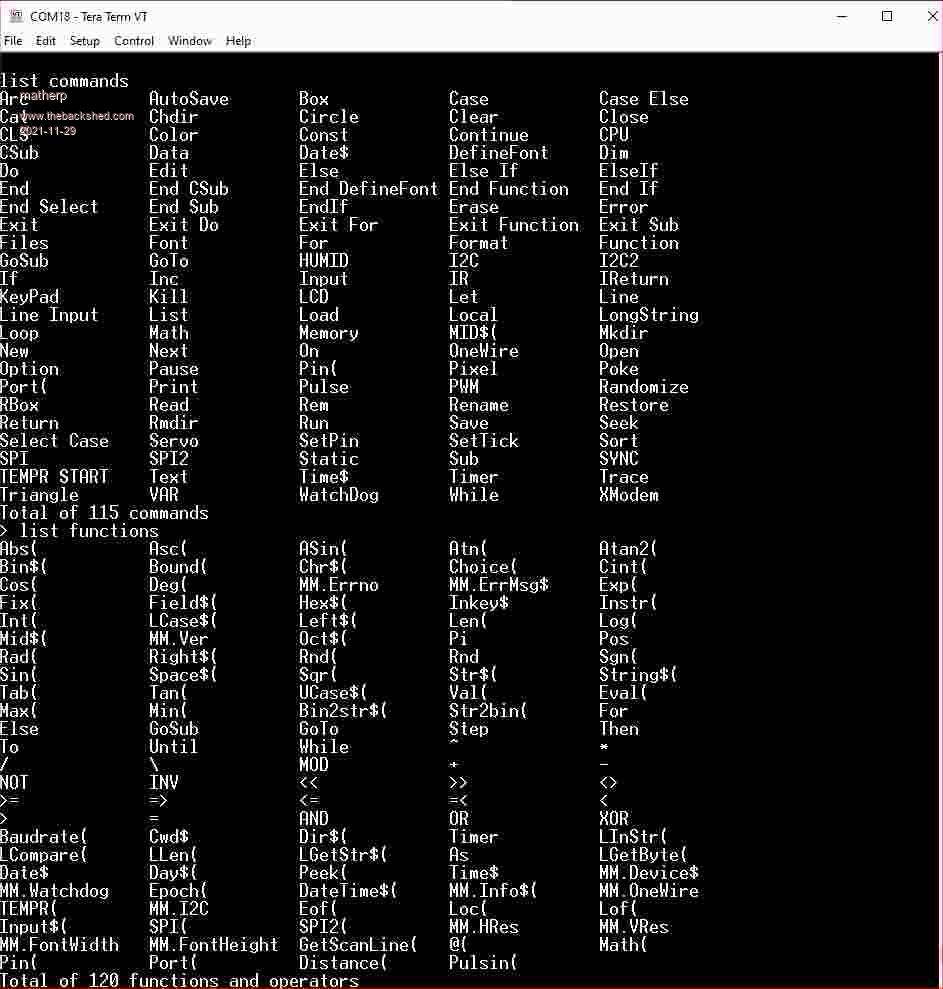

Posted: 02:07pm 28 Nov 2021
411VGAV5.07.00a1.zip
Drawing commands now working, colopurs are 0=black, non-zero=green(depending on which VGA pin you wire)
CAPS/NUM lock leds now working for PS2 keyboard
OPTION DEFAULT FONT fontnum [,scale]' sets the font used as the default. The fonts are the same 7 as the CMM2, default is OPTION DEFAULT FONT 1,1
Defaults PA4 to input with a pullup unless otherwise assigned
Command recall at the prompt now implemented
@ function implemented (e.g. print @(100,100)"Hello")
Anyone up and running yet?
Edited 2021-11-29 00:12 by matherp
