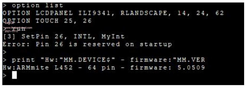

I use NUCLEO-L452 with the MMBASIC ver. 5.5.9, and I have problem to manage touch functions, when I set int on intq pin, I have the follow problem;
I ask to you to solve the problem, Is There a new version for STM32L452 updated?
Can You share the link or suggest the solutions ?

If pin 26 is used for touch detection it's already taken so you can't then use it for your own interrupt. That's why you are getting the "reserved" error.

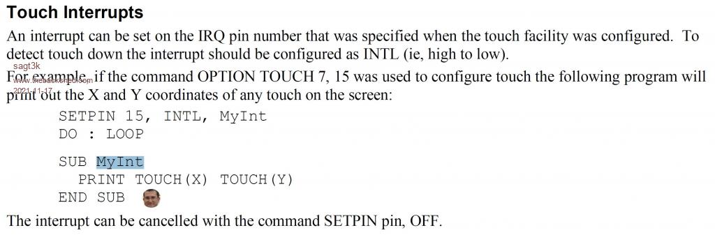

I follow this original example :
For STM32, have you a suggestion to manage LCD+TOUCH+IRQ(TOUCH) ?

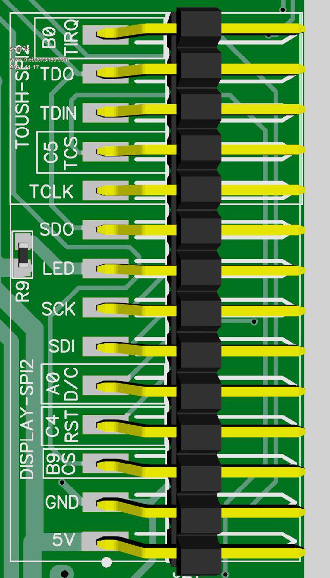

This is my PCB for connect ILI9341.

That functionality isn't enabled on the ArmmiteL4. Easy workaround is to test touch with a settick interrupt
