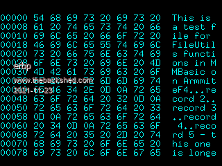

1. The output is formatted differently which allows 128 bytes from the file per console screen to be displayed in Hex and printable characters in Alpha with non-printable chars shown as a period (.) in the Alpha section. This compares to only 70 bytes per screen in the original. Also the format is more readable and I suspect many will already be familiar it - see example screen images below.

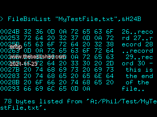

2. The FileBinList syntax has been changed to add an optional Starting Byte Offset, so that you can select the starting position within the file that you wish to start listing from. Note that this is an Offset value so is zero based and may be specified as a decimal value or in hexadecimal using the &H prefix. The default if this argument is not specified is zero, so the listing will start from the first byte in the file. There is an updated Help page for the FileBinList function to show the changed syntax - example screen image also shown below.
FileBinList Output examples - Stream File
FileBinList Output examples - Record Based File

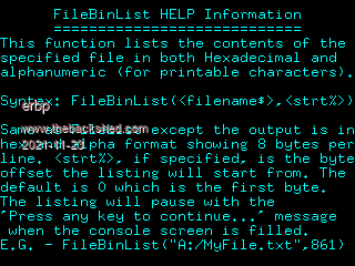

Updated Help Information for FileBinList
