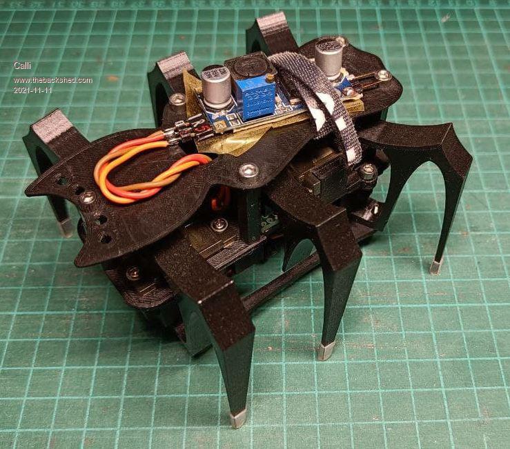

Posts: 74
Posted: 12:52pm 11 Nov 2021
Big shoutout!
Based on this design I was able after years of hesitating to build my second walking robot (first one was done in Lego, toothbrush ones not counted :)!
He just learned his first steps using PicoMite!(after erasing his brain from uPython)
Thanks!
Carsten
PS: The Lego one: https://photos.app.goo.gl/9LvogUuUaRqXM6Jz8
I am still proud how good it works with just two motors.
Edited 2021-11-11 22:58 by Calli
