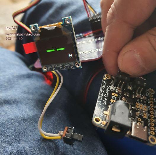

I wanted to make a small GPS speedometer for the dash of my car because I'm sure most of you know the speedometers are not calibrated
They can be up to 10% in error of the speed, reading lower than what you're actually doing.
I chose the Picomite because of it's small size, I had one here, Simplicity and it could do everything I wanted

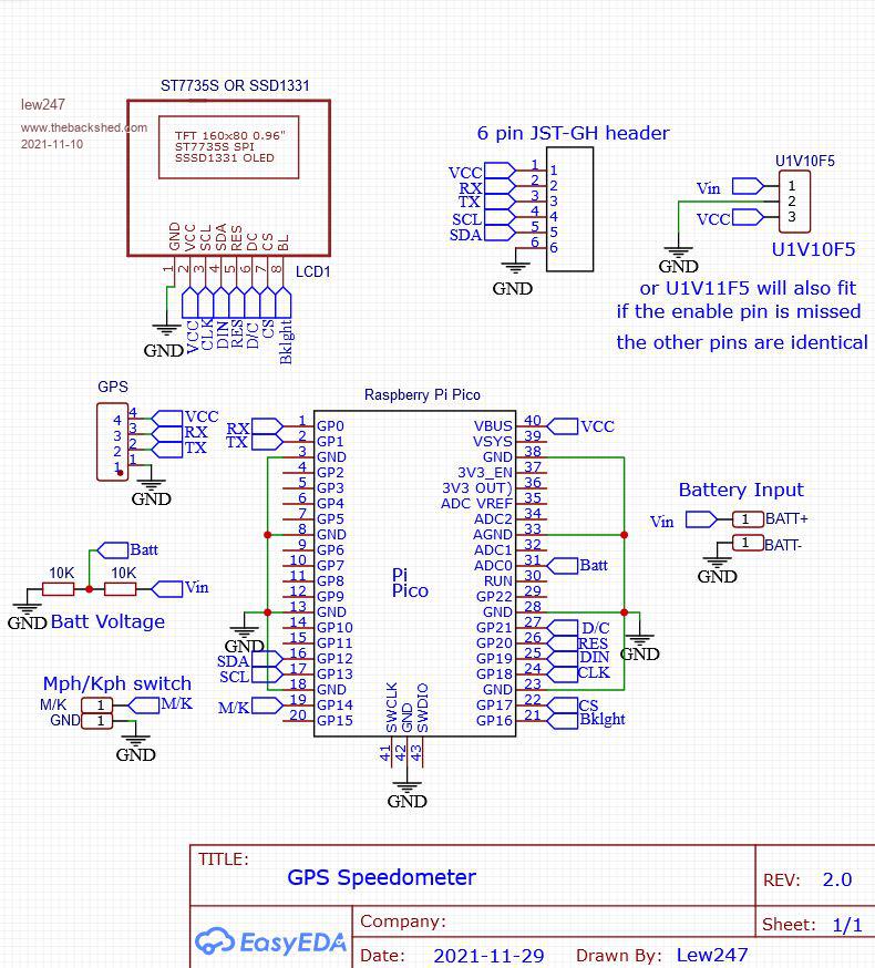

I used an 0.95" 96x64 SPI Full Colour SSD1331 OLED LCD Display Module but the second board I have coming from China will also be compatable with
the 0.96" ST7735S 80x160 SPI Colour IPS TFT LCD Display Module

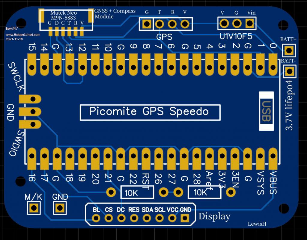

I'll update the code to work with the new display once the new board has arrived from China
For the GPS I chose the Matek Neo M9N-5883 GNSS + Compass Module from here https://www.unmannedtechshop.co.uk/product/matek-neo-m9n-5883-gnss-compass-module/
I chose that module because it's reliable with 10hz update speed and works with GPS, GALILEO, BEIDOU, and GLOSNASS satellites all at the same time
this gives it greater accuracy.
It was important to me that the unit be battery powered and need NO physical connection to the car and be small enough to sit
on the dash in front of the steering wheel and be inobrusive.

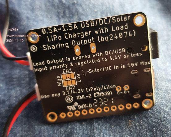

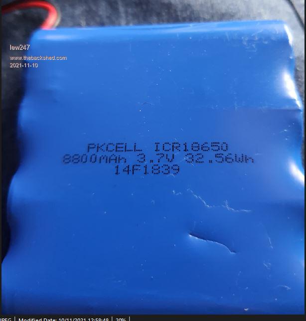

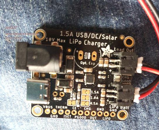

The unit is powered in my instance by a 6800mAh Lifepo4 battery pack, which has a Solar Charger attached and a 6v Solar panel
The solar panel charges the battery even with a fully cloud covered sky in the UK and as the unit has enough battery power
to power it for 90 hours with the cpu at full speed and the unit running continously then it should run forever (or many years)
The code below wakes the display once the speed is at or above 3mps/kph
I chose this value as sometimes when stopped the gps shows tiny speeds and I wanted to make certain the car was actually moving.
Once the speed is 0 a timer starts
If it has been 0 for greater than 1 minute then the display turns off, the cpu sleeps for 5 seconds, wakes for 200ms to check for
movement, it there is any it checks the speed, if it's greater than 3 then the display comes on and the unit works as normal.
If it's below 3 then the unit goes back to sleep to save battery power.
I could save more power by slowing the CPU down, but I haven't done this yet.
There was a lot of problems once the code was working where the display would not update in real time, it was really lagging
and on investigation it was missing GPS(Valid) signals from the Pico once it woke up from sleep.
The way this was fixed was the following
Increase the baud rate to the Pico to 460800 and use the GPS config tool on the PC to change the sentences being received.
I turned off every sentence other than the $GNRMC sentence which we actually need.
This gave it 100% reliability
but the update of the display was still not in real time
I then used the same tool and changed the GPS update rate from 1hz to 10hz
This cured all the problems, the display shows the slightest change in speed in real time and looks beautiful I think

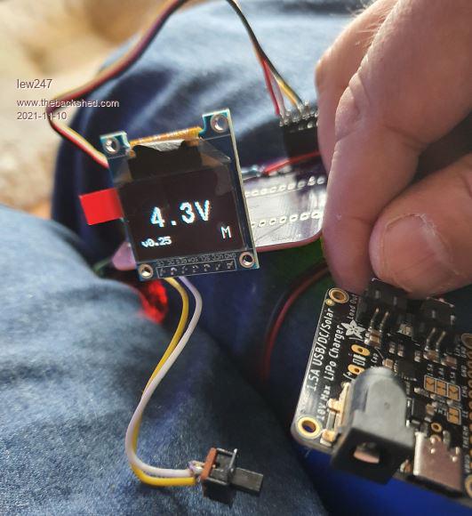

The display shows the battery voltage on start up and if the voltage drops below 3.2V then the K and M indicators are
replaced by a B for battery.

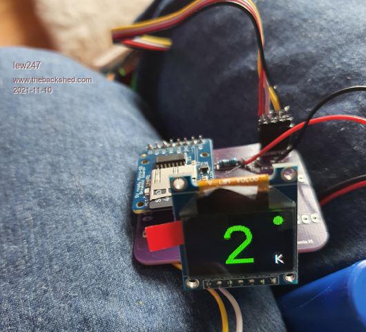

Once it has a valid satellite lock there is a green dot on the top right corner of the display indicating a valid GPS lock
There is also an M and K indicator at the bottom right to indicate if the speed is MPH or KPH
I have a switch wired to the Pico this lets you select MPH or KPH
I used this because I sometimes drive to Ireland which uses KPH, if you only use one and not the other then the switch can be omitted
The new board that is coming doesn't have the SD card you can see in the pictures below because it isn't needed
I added a connector for a U1V10F5 battery to 5V buck convertor
An U1V11F5 will also fit if the enable pin is missed, the other pins are identical
They both boost the voltage to  5v output from any input from 0.5V
The board has 3.7 Lipo4 battery only written on it but I put that on the board before I decided to use the new power up module
This means the unit can be run on any battery from 0.5v up
as long as the voltage isn't over 5V
I think the program has enough comments on it to be self explanatory but if it doesn't just ask.
Again many thanks to Tom for his invaluable help without which this code would not be possible
Once i get the new display that is wider I'll update the code to show the changes and if I ever get the built in compass working
then I'll get that incorporated into the display as well
Has anyone in the UK got a 3D printer that they'd be willing to make a case for this?
I'll be willing to pay for it

This is the circuit for the updated board with support for both displays
It does not have an SD card as it isn't needed for this project
This looks really messy as it's sat on my lap and I don't have any kind of case to put it in yet.
Power up display
After Voltage reading but waiting for a valid GPS lock
GPS lock with MPH
GPS lock with KPH
Battery pack
Solar charger
back of Solar charger

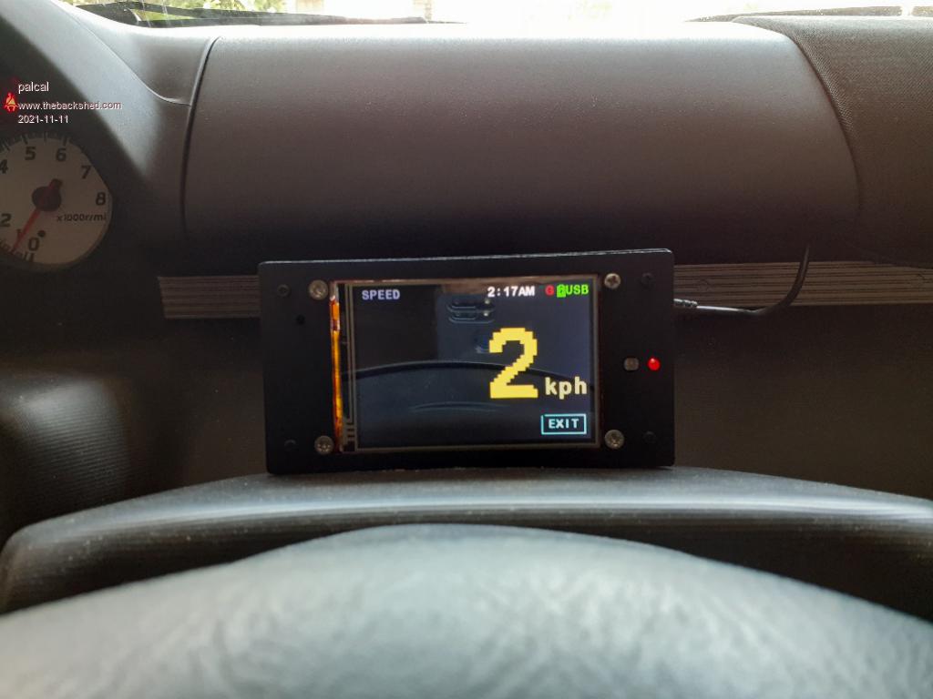

I made a GPS speedo for my car, I just plug it into a USB charger in the cig. lighter.
Edited 2021-11-11 07:19 by palcal
