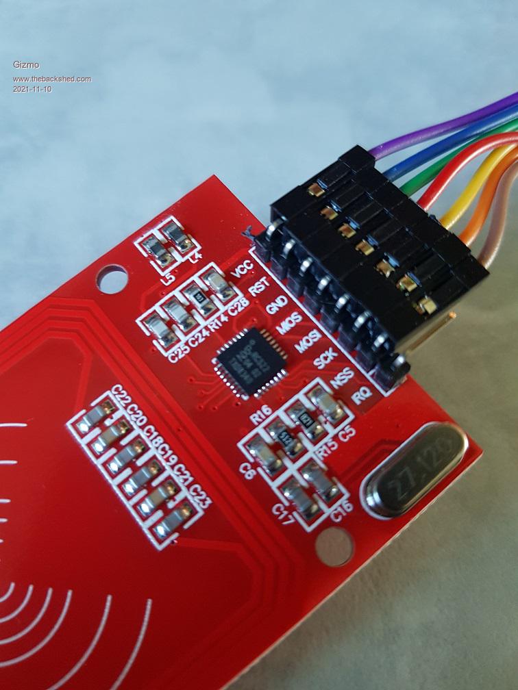

My RFID-RC522 module seams to be a new batch, its labeled differently to every single example I've seen on the internet.
The modules and wiring examples I've seen online have the following pins -
VCC, RST, GND, IRQ, MISO, MOSI, SCL, SDA
Mine is labeled -
VCC, RST, GND, MOS, MOSI, SCK, NSS, IRQ
Which would explain why my tests have all failed.
Edited 2021-11-10 15:20 by Gizmo
Posts: 6626
Posted: 05:59am 10 Nov 2021
Apart from the pin labeled MOS (Which should be MISO), your board matches the project sheet from Jaycar

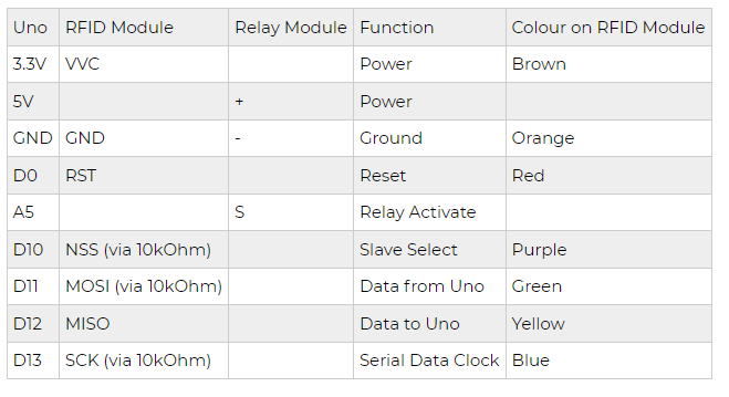

The Raspberri Pi projects use the SDA pin, which from what I read is for I2C but could be wrong. Starting to think maybe the Pi projects use a older board and the Python code modules wont work with this board. eg - https://www.raspberrypi-spy.co.uk/2018/02/rc522-rfid-tag-read-raspberry-pi/
Another reason to use the Micromite instead
Hoping circuit can share how he wired his up and the code, saves reinventing the wheel.
