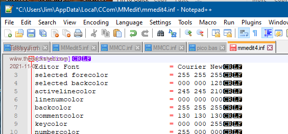

Posts: 6594
Posted: 12:57am 07 Nov 2021
  Tinine said
Are we able to change the font in MMEdit yet, Jim?
Yes.
But you can do that now.
Edit the first line of the mmedit4.inf file
Anything that is not a mono spaced font will not work well.
