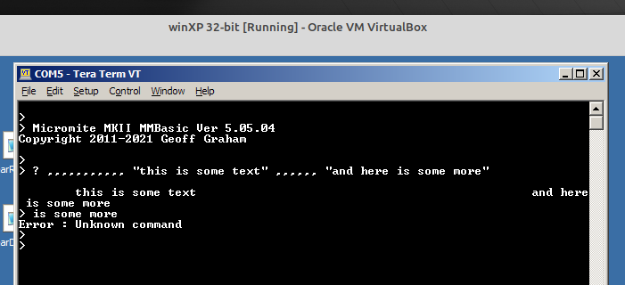

here is it doing something even stranger, winXP (VM) and teraterm:
the printed output is overflowing into the input buffer.
