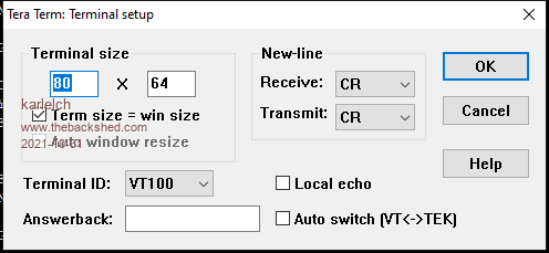

Command stacking
I like this feature a lot, but there seems to be some problem when the cursor is moved and the command is edited. If one goes back with the cursor and deletes/inserts characters, they appear at the wrong position and what one sees in the line is not what is given to the interpreter when pressing Enter. Looks like a simple indexing offset.
Posts: 12084
Posted: 08:16am 31 Oct 2021
  Quote   like this feature a lot, but there seems to be some problem when the cursor is moved and the command is edited. If one goes back with the cursor and deletes/inserts characters, they appear at the wrong position and what one sees in the line is not what is given to the interpreter when pressing Enter. Looks like a simple indexing offset.
This happens if the window of the terminal emulator is less than 80 characters wide. Please ensure this is the case and try again
karlelch
Joined: 30/10/2014
Posts: 361
Posted: 10:36am 31 Oct 2021
Hmm not sure. I use TeraTerm, it is set to 64 lines w/ 80 characters.
In MMBasic, I used `option display 64, 80`.
Here is an example of what mean:
> print 1,2,3
1       2       3
Now I retrieve the previous line with the up key and press backspace; this is how it looks then:
>print 1,2, 3
1       2
Next, I again get the previous line back and type 444, and here is the result:
> print 1,2444
1       2       444
Still, it is possible then I have some TeraTerm setting wrong.
Posts: 12084
Posted: 10:49am 31 Oct 2021
I can't replicate so I can only suspect something else in the teraterm setup.
You could try the attached to see if it makes any difference
PicoMite.zip
karlelch
Joined: 30/10/2014
Posts: 361
Posted: 11:02am 31 Oct 2021
Yes, now it works as expected! Thanks.
