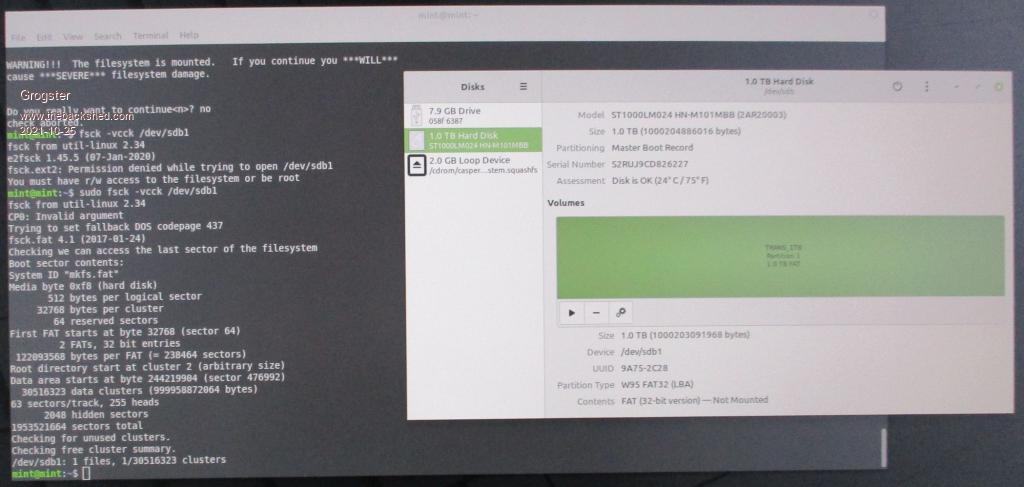

Posts: 10028
Posted: 06:43am 25 Oct 2021
fsck seems happier then smartctl:
However, this completed in about three seconds.  Is it still running in the background?
scruss?
The activity LED on the 1TB USB3 drive blinks about once every ten seconds or so, so I am wondering if this is a backgrounded thing?

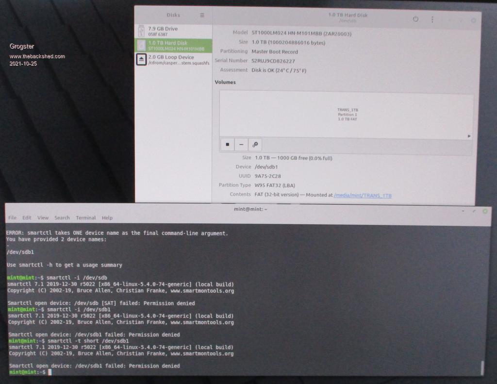

Posts: 10028
Posted: 06:44am 25 Oct 2021
The thought just occurs that my smartctl attempts might have been getting denied as I did not run the command as sudo....
Yes?

Posts: 4375
Posted: 11:22am 25 Oct 2021
Yes, you'll need to run smartctl as root
It can wipe a drive of all data so is not by default runnable by a non-root user.
scruss
Joined: 20/09/2021
Posts: 116
Posted: 02:45pm 25 Oct 2021
Not sure if badblocks runs on anything but ext filesystems. Looks like fsck.fat didn't even try.
ext4 is basically the same as ext2, but with journaling. ext2 tools used to be slow because, before SMART was everywhere, they assumed you had to check everything, Now many of the tools check SMART, see it's fine, and skip real checks.

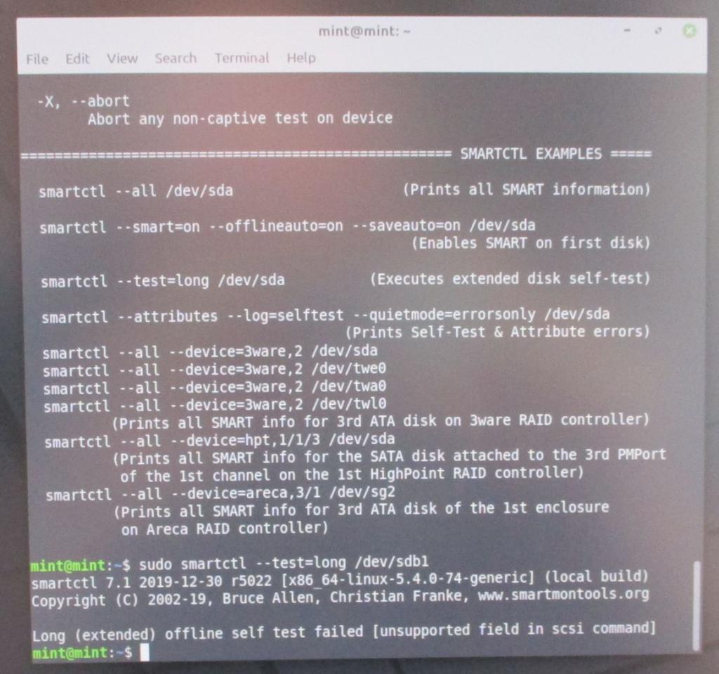

I've played with smartctl again, and it is now moaning about an unsupported field in the command, even when I use their own example from the help:
I have tried other variations of this, but they all report the same thing.  For example: smartctl -t long /dev/sdb1 as in the example in JohnS's post above, but that also generates the same error.

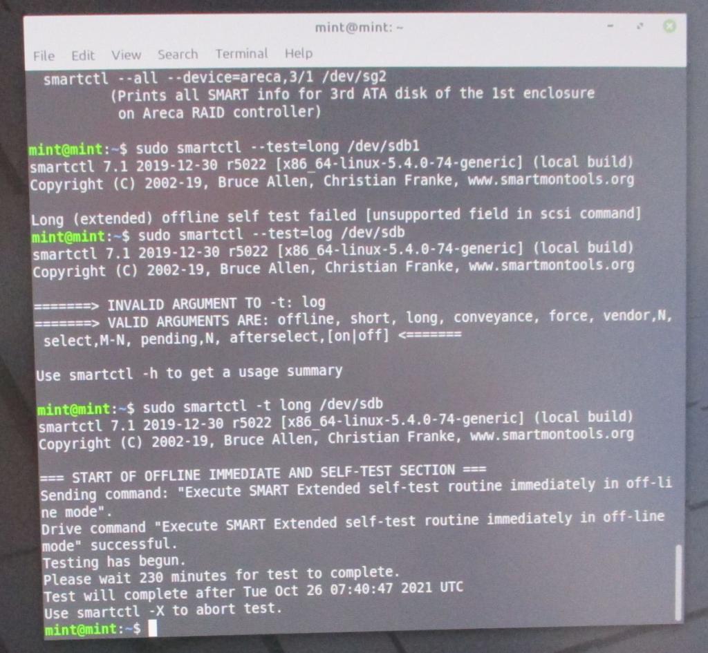

Posts: 3872
Posted: 01:37am 26 Oct 2021
I don't know all the circumstances, but does it need to be /dev/sdb instead of /dev/sdb1?
Posts: 10028
Posted: 03:51am 26 Oct 2021
Nice idea.  Mint assigns the drive the path of /dev/sdb1, so that is what I used, but I will try leaving off the number....
Bugger me!
You were quite right.
I was using the Mint path, as I thought that was what the path was or is.
Posts: 3370
Posted: 05:33am 26 Oct 2021
/dev/sdb1 is the partition path - allows fs checking only.
/dev/sdb is the disk hardware for bad sector checking.
