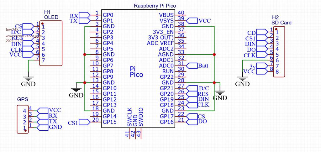

I cannot get the config right, I'm pretty sure I know how to get Com1 configured but thats for once I've got the display and sd card working
can anyone tell me what I'm doing wrong please? and how to config them properly?
I'm reading the manual and trying for several hours but can't see my mistake
OPTION LCDPANEL SSD1331, OR, DC, RESET, CS
Initialises a colour OLED display using the SSD1331 controller. This supports 96 * 64 resolution.
> option system spi gp18,gp19,gp16
> option sdcard gp15   'this SHOULD work???
> option lcdpanel L, gp21,gp20,gp17
Error : Syntax
Edit, it powers up and the sample test programs at the start of the manual work fine

  Quote  option lcdpanel L, gp21,gp20,gp17
Try
option lcdpanel ssd1331,L, gp21,gp20,gp17
lew247
Joined: 23/12/2015
Posts: 1709
Posted: 12:48pm 21 Oct 2021
Works beautifully Thanks Peter.
