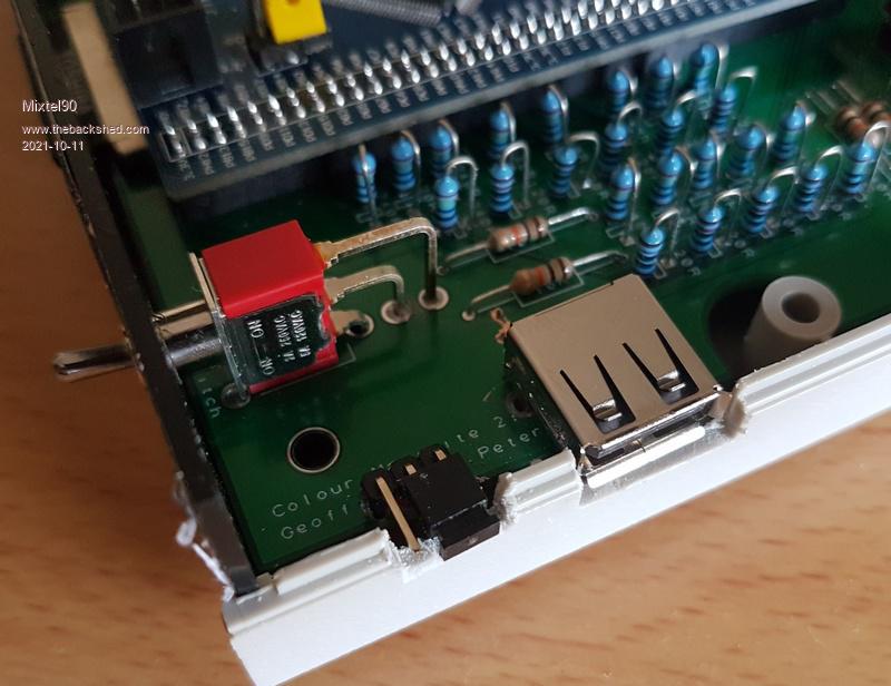

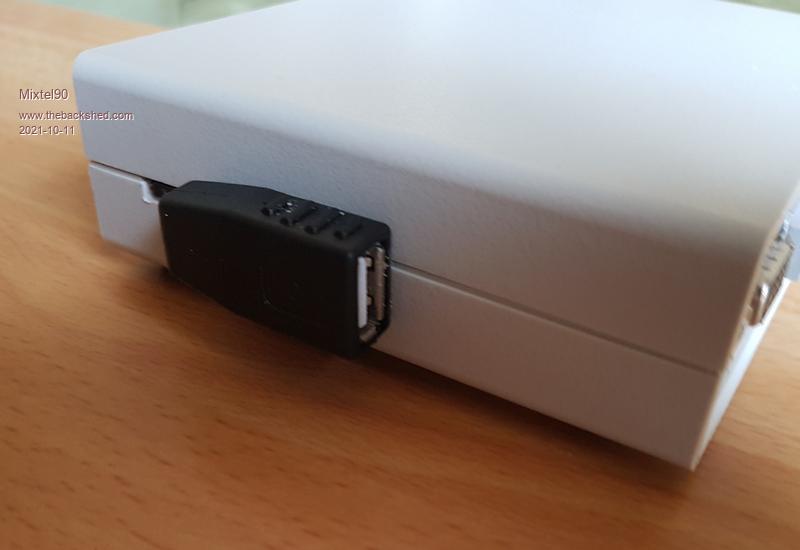

I did an internal mod that I found on here, bringing a USB socket out to the RHS. Using right-angle USB converter has brought the mouse lead out at the back, and the GPIO port clear. A later mod to the mod that I have in mind is to have a jumper on the RHS that will disable the pullup resistors for the mouse and leave the GPIO port clean.

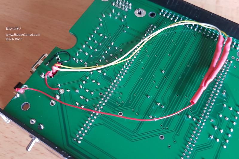

I put the pull-ups from pins 32 (data) & 33 (clock) inside, under the PCB. My intention is to feed the supply side of them via diodes from the centre of a 2-way link, either to supply (mouse on) or to ground (mouse isolated).

If I can just put my hands on that long-handled link (that I'm sure I have "somewhere safe") I'll do that additional isolation mod on mine. I did consider just putting a link on the bottom, but it would need a reasonable size hole to get to it to make the changeover. I didn't want to put the resistors in the mouse lead as I may want to change the mouse at some point.

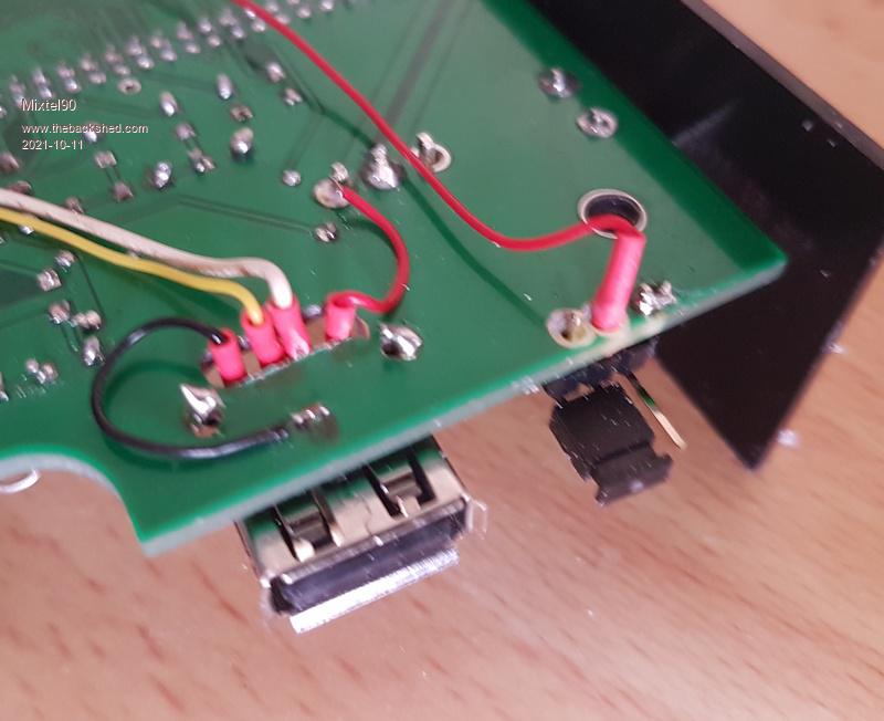

Just a couple of points for those who intend doing this mod:
 The top side copper is at 3v3 and the bottom side is GND. It's *very* important that you remove the top side copper from around the socket lugs before you solder it in. A few twists of a drill does it nicely. The socket has plastic mouldings on the bottom so it doesn't rest on the top copper.
 The FR4 PCB material is *very* hard and cutting the slot may be difficult using ordinary drills (use a sharp one). I just happened to have a solid tungsten carbide bit that did it nicely. Finished off with a little diamond file.
 The adapter that I used is described as a RIGHT direction. The ebay ad was confusing as the photo was of a LEFT version. :)

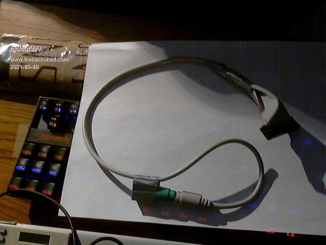

Why not make a cable as I did for my Gen 1.  It allows you to use either PS/2 connectors or USB for those duel mode mice.  The two pull-up resistors are inline.  It is very robust and works well.  I am adding a ESP-01 WIFI module when it arrives so I have WIFI and mouse on one cable for my Gen 1. It won't look elegant but it should work well.

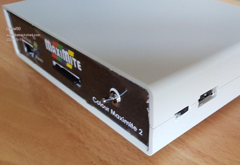

Posts: 9273
Posted: 03:26pm 10 Oct 2021
Yippee!! It's working! :)
The link switches the common anodes of the diodes between 3V3 (mouse enabled) and ground (mouse disabled - the diodes are reverse biased so the resistors are effectively out of circuit). Each diode cathode feeds a pull up resistor, one to pin 32 and one to pin 33.
