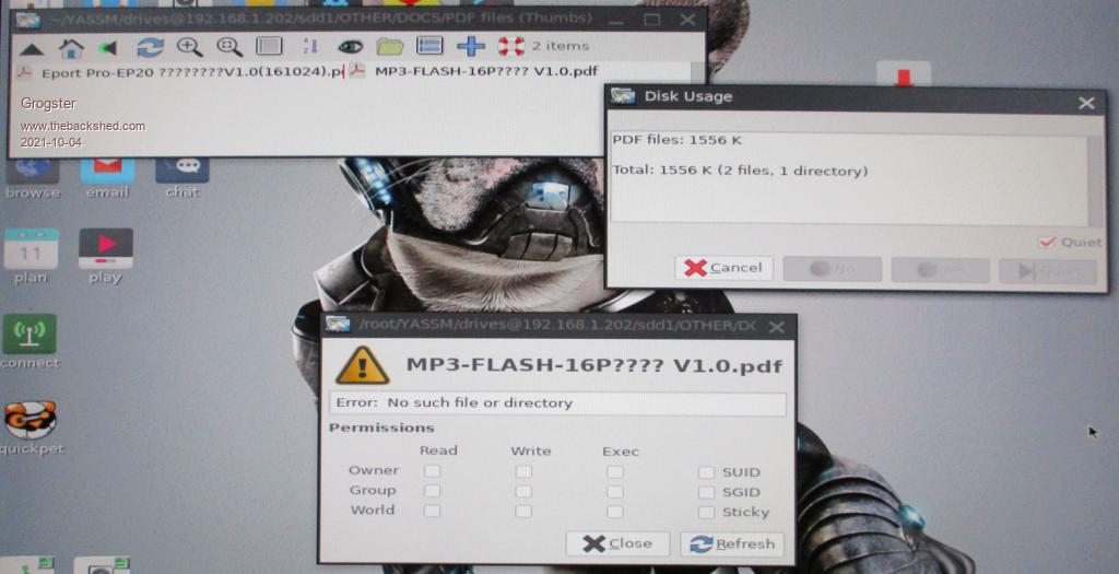

I am getting this error with two files on an ext4 volume.
Linux insists that the file or directory does not exist, but it most certainly does.
I can get properties of the DIRECTORY that holds then, but trying to get the properties of either of these two files, generates the error.
I tried to rename the files, thinking that the question marks might be illegal or something in the Linux filesystem, but I just get the same error, so can't rename them either.

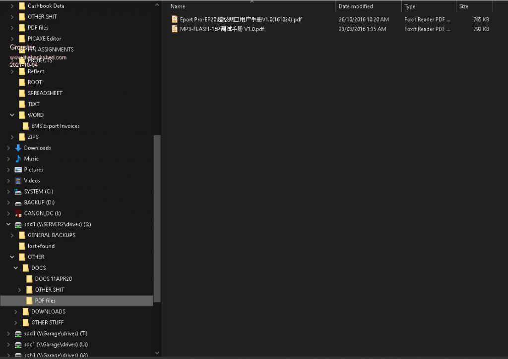

Windows sees the files with Chinese characters in the filename - which is probably the issue(Linux does not like that), but I thought you'd be able to rename the files inside of Linux, even if the filename was illegal.  More to the point, I'm surprised that Linux would even ALLOW you to copy files to it, if the filename had illegal characters in it.......
I can certainly try renaming the files from inside Windows, but it would be nice to know of a way to do it inside of Linux, and not to have to rely on Windoze to change it - I only have one Windoze machine left, so would like to know a Linux method to get around this issue in the future.

@ Mixtel90: No, it's ext4 on a Linux machine, mapped to the Windoze machine on the network.  But the actual volume is Linux ext4.
@ epsilon: Found the solution....
I cannot change the names via the NETWORK using Linux machine #2 to rename the problem files on Linux machine #1.

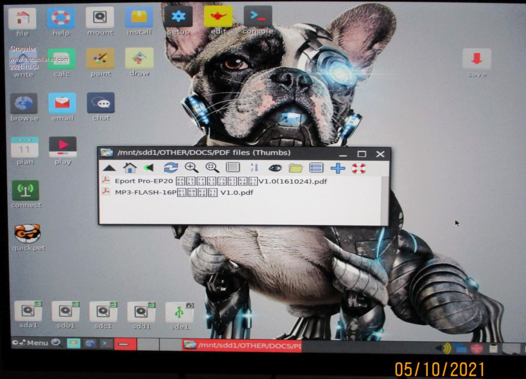

Screenshot from Linux machine #1:
Same two files, but this time the Chinese characters are replaced with boxes with numbers in them in the filename.  I can get the properties of these files on the LOCAL machine, and I can rename them fine - so I have.
A strange one, but easily fixable so long as I use the local Linux machine and not make the attempt via another Linux machine, SAMBA and the network.

Looks like part of the initial confusion was that the file name does not include any "?" (question mark) chars, although some tool(s) show the (weird, unicode) chars that way.
