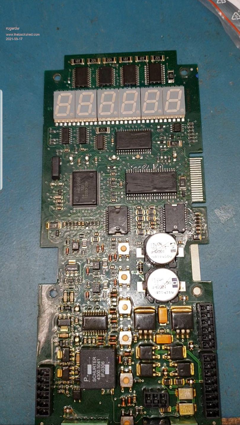

  Quote  Do you have pics that you can share?
This is the type I've been struggling with this week, though I did get another two going today  ...  so a bit of progress.

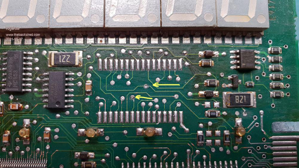

This is where the fault was with the first one  ...  two open circuit tracks right where they join to the feedthroughs  ...  underneath an SRAM chip.
So much for the conformal coating  ...  seems some water got in under the chip and caused the issue.

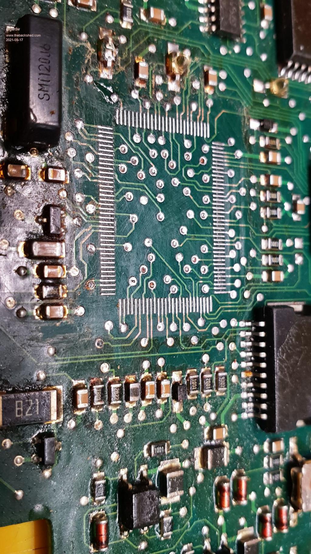

Finding this fault gave me some hope for the next one  ...  but that ended up having a crook multiplexer IC  ...  145 ohms between vcc and gnd. Took a while to find that too.

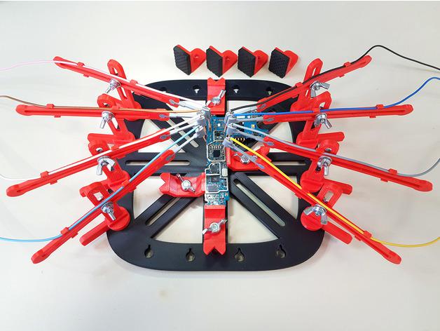

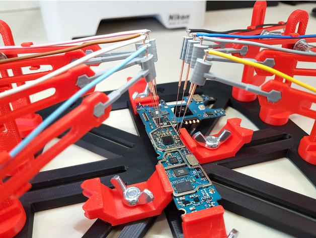

not a technique, but consider using a pcb test jig that holds the board securely and has "cranes" with wired pogo-pins that can easily be positioned to contact specific parts of the board. Its then really easy to get onto interesting bits of the PCB without slipping or dislodging other bits. I don't use it often but when i have a right sod of a problem, this is a godsend. Not having to "be careful" but having 8 umbilicals that reach all points of concern removes the risk of knocking things out and shorting pins with probes - which makes the debug go smoother.
I 3D printed mine and it works really well. The original design used acupuncture needles as probes. I have a mixture of cranes with those and pogo-pins (which do for most things) but for tiny SMD package ICs, the needles can be very helpful.

  CaptainBoing said  not a technique, but consider using a pcb test jig that holds the board securely and has "cranes" with wired pogo-pins that can easily be positioned to contact specific parts of the board.
I may be able to do that with some boards  ...  but most with the conformal coating probably would not work. I have to regularly sharpen my probes to punch through  ...  and very often I have to go back over because it's so hard to get reliable readings.
I'll certainly give it some thought though because it could save me a lot of time if I could make it work.

Posted: 04:43pm 17 Sep 2021
not my work, but this is the one I printed - works well. Is a dream when I have to get the saleae out (bugs fall fast when that is on the job!)
source is here https://www.thingiverse.com/thing:3615910
