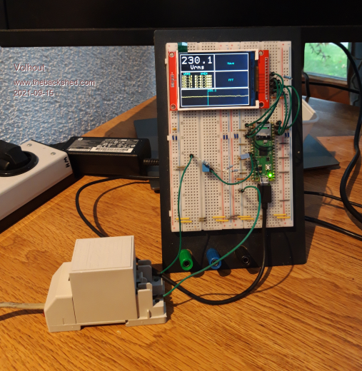

In my neighborhood solar panels are popping up like fungus on blue cheese. And recently I have lost 2 mains adapters. Technician as I am I noticed by opening up the adapters that in both cases the input overvoltage protector (MOV) was blown. So I am worried the grid voltage exceeds normal voltage tolerances.
To measure these, I am developing this mains voltage logger based on a RPi pico running MMBasic. For this to work you need at least 5.07.b17.

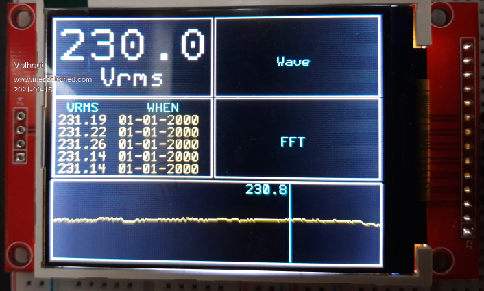

Here are some pictures of the development.
I am using a small bell transformer for isolation from the mains and a voltage divider using ADC in the pico on GP26. The logger measures continuous in the background and samples the mains at 2kHz (40 samples per sine wave at 50Hz) using the ADC command. Using of MATH functions process the data to an RMS value (actually MATH(SD array()) does a perfect ac-rms on it's own including dc cancelation.
It is work in progress as you can see from the pictures.
Missing is:
- RTC
- FFT graph
- Waveform Graph
- logging events on SD card

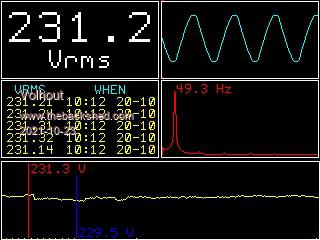

Finally got time to pick this up again. The code is growing quite big for the build in editor. I have been using a lot of defines based on MM.Hres and MM.Vres, but it is becoming so complex I may drop the variables and hard-code (just to clean up the code).
It is going to be 1 one-off anyway.
Tried to upload a "BMP" file, created by SAVE IMAGE xxx, but the forum would not cooperate...
Posts: 3418
Posted: 11:02am 22 Oct 2021
Converting BMP to PNG or JPG first seems to allow upload.
Tinine
Joined: 30/03/2016
Posts: 1646
Posted: 06:17am 23 Oct 2021
@CaptainBoing
Posts: 6204
Posted: 08:05am 23 Oct 2021
jpg
png
png looks better, even at 100% quality of jpg
Pico, LCD and 6 components....
And a lot of math...
thanks Peter, especially for the ADC function.
The code runs 3 levels interrupts
top level: sampling (machine code, Peter does all that)
lower level: interrupt buffer full
lowest level: timer interrupt (refresh screen every second)
What I still have to do:
- implement RTC (I now enter date and time, but the pico time$ is not really accurate, need to add a DS3231).
- save events to SD card (complete ADC samples array, so you can actually analyze what went wrong, a single peak, or constant level, or outage).
Once I have a publish-able version (with comments) I will publish here.

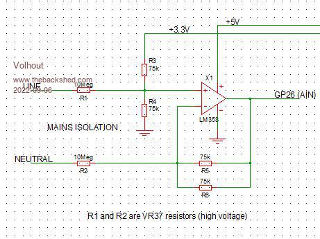

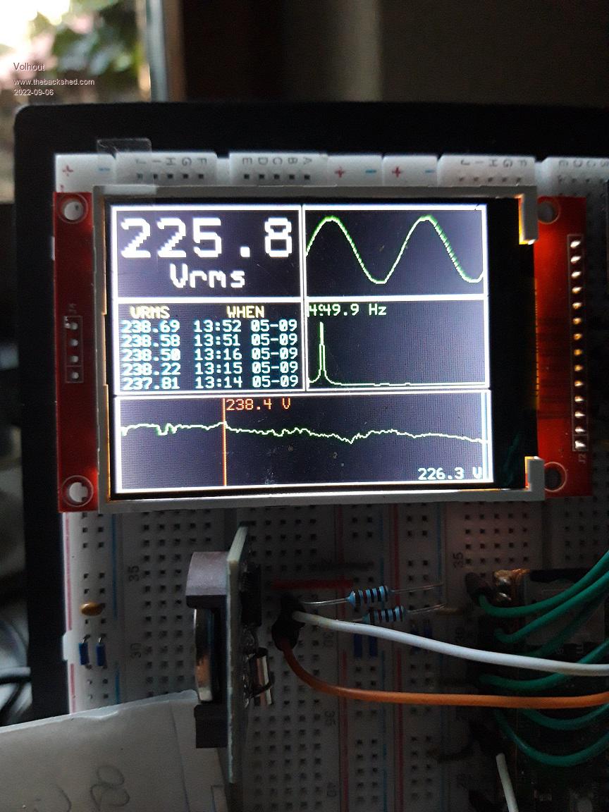

1/ Calculating the mains frequency from the FFT gave jittery results and some drift. Therefore the mains frequency is no measured using the picomite frequency measurement and some averaging.
2/ The mains isolation was in a transformer. But the (small) transformer gave additional distortion. (original plan wat to use the transformer to both power the pico and LCD, and use a isolated measurement input. I now use a solid state (opamp) circuit with (dual) 10 Meg ohm high voltage resistors. This is far superior in distortion. Powering the pico will use a phone charger.
3/ some cosmetic changes (minor)
4/ the trend graph shows 320 minutes (5 hours) of rms voltages. Attached graph below shows the influence of the sun setting on the mains voltage (solar panels in the neighbourhood).
5/ RTC implemented
Edited 2022-09-06 18:58 by Volhout
