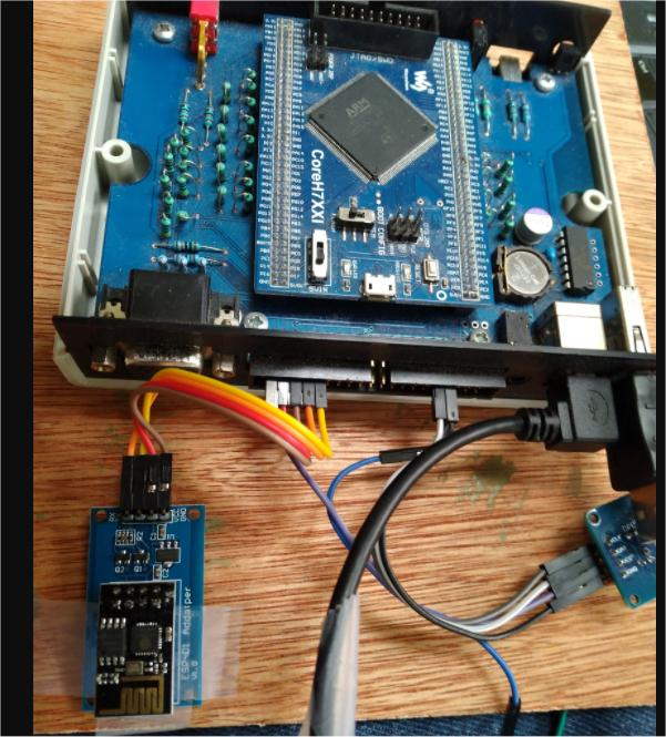

Could any of the two solutions be installed on the inside? Do you have any picture of the setup?
Posted: 06:38pm 09 Sep 2021
  grinoir said  Could any of the two solutions be installed on the inside?
Not so easily, I think, for the original CMM2, though if you want to solder wires directly to the 2x20 header insider the case, all 4 are side by side and on top, so they're accessible.

grinoir
Joined: 12/09/2020
Location: Denmark
Posts: 11
Posted: 11:21pm 12 Sep 2021
Thanks lizby, that seems like easy enough. What is the other module you have connected?
toml_12953 do you have a photo of your solution?
I would really like to use my CMM2 ver. 1 (or ver 1 1/2: looks like ver. 2 inside but without the new connections. I got a ESP-01 here, so a "clean" solution without extra boards would be my preference if possible.

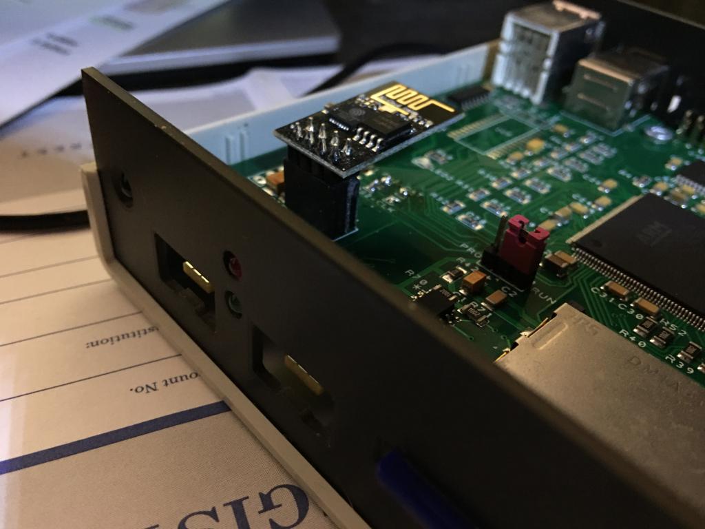

toml_12953
Joined: 13/02/2015
Posts: 736
Posted: 12:23am 13 Sep 2021
  grinoir said  Thanks lizby, that seems like easy enough. What is the other module you have connected?
Here it is:
Posted: 01:04am 13 Sep 2021
  grinoir said  What is the other module you have connected?
PS2 socket module for mouse

Posts: 9273
Posted: 03:49pm 13 Sep 2021
That is mounted on a CMM2 2nd Gen from PS Labs in Poland. The connector (or even pads for one) isn't fitted to most versions of the CMM2 so the ESP can't be mounted inside the case - unless you are prepared to do a lot of messing about...

toml_12953
Joined: 13/02/2015
Posts: 736
Posted: 11:42pm 13 Sep 2021
  Mixtel90 said  That is mounted on a CMM2 2nd Gen from PS Labs in Poland. The connector (or even pads for one) isn't fitted to most versions of the CMM2 so the ESP can't be mounted inside the case - unless you are prepared to do a lot of messing about...
The pic I posted was from a unit bought from a New Zealand dealer. It doesn't include the socket but does include the pads for it so I soldered in my own.

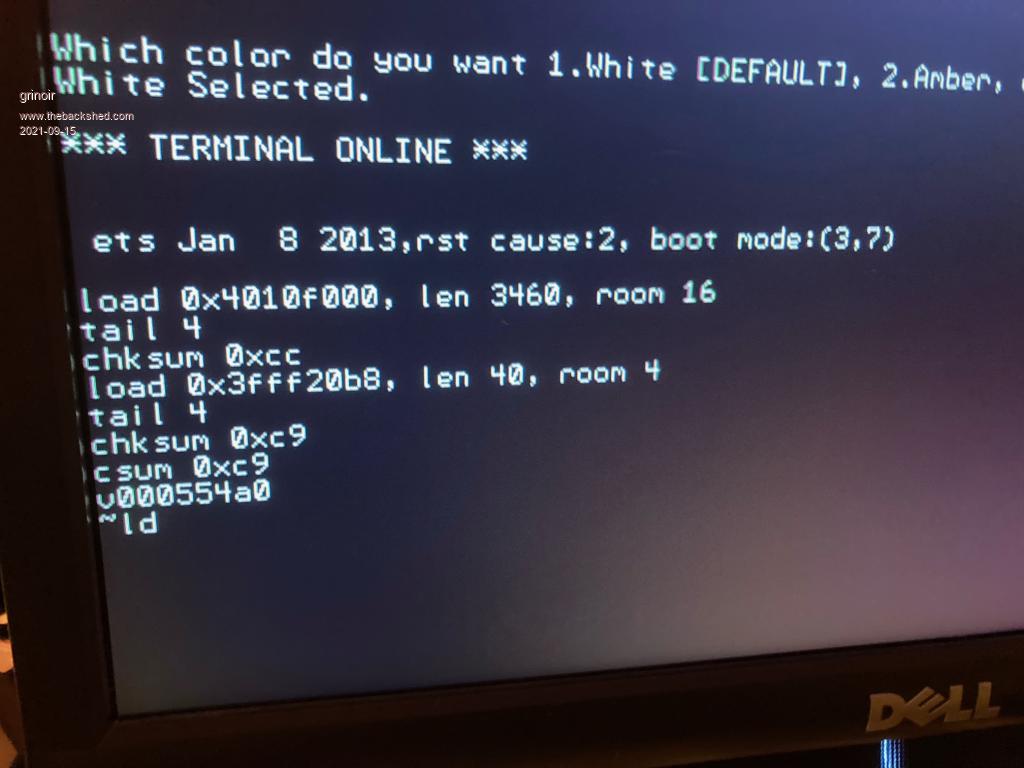

Hi again,
More luck but not quite. I apparently had and NODEMCU in my drawer:-)
Using the guide by Jay Crutti https://www.jaycrutti.com/hardware-projects/homebrew-wifi-modem-for-cmm2 i uploaded the firmware, connected the NODEMCU and ran the program.
So far so good.
However using the default 115200 default BPS I got this error.
The "error code" don't look like the usual "wrong BPS-code" but I of cause tested all the options to no luck.
Any ideas?

Posted: 06:19am 15 Sep 2021
Hi,
for me it looks like error from ESP firmware. Maybe HW watchdog or low voltage + reset? How did you program the ESP? It's running OK without connecting to the CMM2?

Posted: 05:43am 16 Sep 2021
  grinoir said  However using the default 115200 default BPS I got this error.
I recall seeing an issue ticket opened on the Zimodem GitHub that there may be a bug in the recent esp libraries so you might need to install a specific version of those. Or it could be a misconfigured board profile when you uploaded using Arduino IDE like incorrect ram or similar setting.
