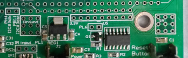

CircuitGizmos
Joined: 08/09/2011
Posts: 1427
Posted: 03:10pm 30 Aug 2021
Below the sea-of-holes on the RetroMax are unpopulated connections to Gnd, 5V, and 3.3V.
Twiggy
Joined: 30/08/2021
Posts: 5
Posted: 10:34pm 30 Aug 2021
Thanks everyone who commented so far, glad I posted this, or I would not know about the onboard power options of the RetroMax.
