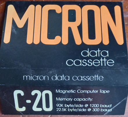

Somewhere in the shed I have a few microbee tapes. I used a bog standard cassette player but lashed out on data grade tapes.
I even found one on the bookshelf here.

Just for curiosity, it might be interesting to play one of those tapes into a PC with  audio software such as Audacity to see what the data really looks like. My recollection above may not be right.

Unfortunately, the cassette from the cover I photographed is missing so I still have to search the shed. Then find a working cassette player.
