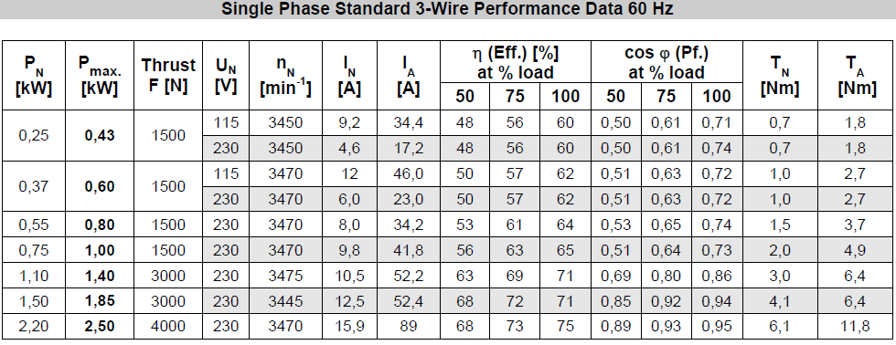

That's a huge difference for a pump after a minute. Even a really bad power factor shouldn't do that. A 15A breaker should have tripped. I'd be tempted to check the motor current with an ammeter as I'm not convinced that the reading is anywhere near accurate.

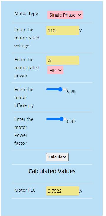

  Mixtel90 said  0.5hp = 370W = 7.9A FLC at 110V
Why does this FLC calculator say that a single-phase 110V .5hp motor should have an FLC of 3.7522A?

I think that's what I was saying some posts ago (if we're talking about the same thing). The GUI site "Power" line in watts is the rate which, if maintained over the course of an hour, would use that many watt-hours. In fact, divided by the approximately 1-minute run time (1033/60=17.2) gives about the watt-hours used which is reported by the telemetry, 14-watt-hours.
  Mixtel90 said  That calculator looks wrong. I think it's actually using a 240v setting no matter what you specify. :)

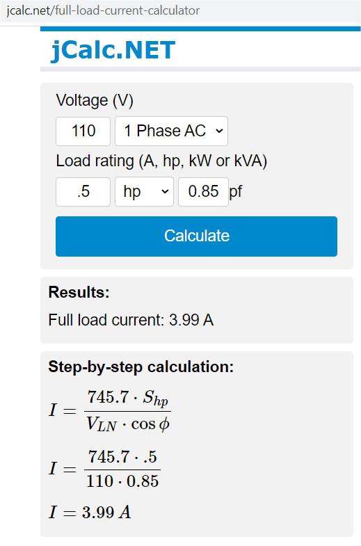

Here's another FLC calculator which gives (nearly) the same results as the other one, including the formula it used to make the calculation. Is there something wrong with that formula, or why does the result differ so significantly from the charts you link to?

Remember that the designed rating and FLC of a motor is what's written on the nameplate though. Everything else (including calculation) is a generalization. Motors vary a lot in efficiency. Efficiency varies with load, as does load current.
If your pump is very lightly loaded then it's quite possible that the current drawn is very low. The FLC is the *maximum* current that the motor should be allowed to draw.

Frustrating that the calculators and charts differ from each other by about a factor of 2.
