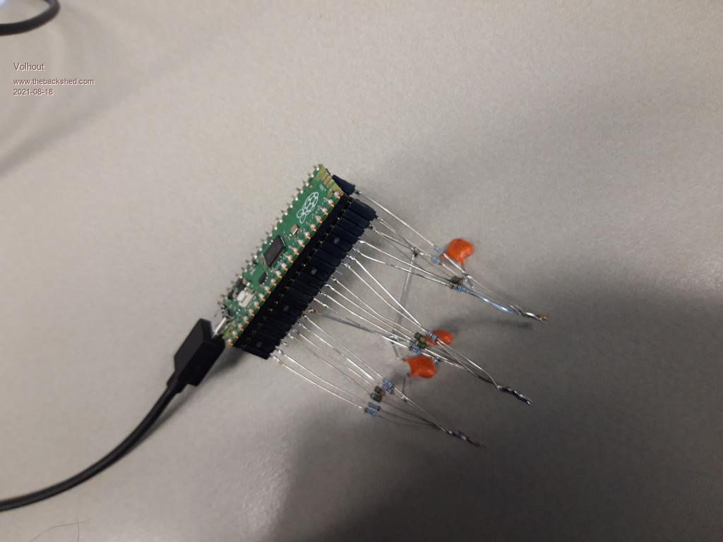

I have a quick solution in using the PORT command.
On the pico, using GP0..5 for phase 1, GP6..11 for phase 2, GP12..17 for phase 3
3x 6bit DAC's with resistors, and low pass filter cap to terminate (remove the DAC steps somewhat). The resistor DAC is particular accurate (1.1k, 2.2k, 4.3k, 9.1k, 18k, 36k), the filter caps are 1uF.
I create an array with sine, and sine shifted values.
An in a single PORT command I write the 18bits (3x6bits) to the IO pins.
Currently the program relies on the MMBasic interpreter execution speed (so any new compile may result in re-tuning). The output frequency (50Hz) is determined by the length of the array with samples. More data = lower frequency.
With default speed (125MHz) 210 samples result in 50Hz. No need to align the number of samples with a multiple of 3 (as a HW guy would do, to make exactly 120 degrees shift possible) since the sine values in the table are phase shifted with "float" accuracy...hihi.

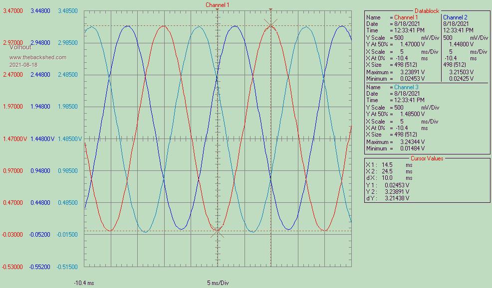

The test circuit:
The output signals measured with a 4 channel oscilloscope.

I like that. It's got bits hanging in mid air, just as they should. :)
It seems to be working fine. If you can prove it at 60Hz it might be worth trying to get some closer resistors if you need less distortion.

The jitter is less than 1us.
// 3 phase generator
// This is a 50Hz 3 phase (L1/L2/L3) generator running on ATMEGA328
// Outputs are 3x 6 bit ports, that need an external DAC (resistor network).
// In prototype setup 36k, 18k, 9.1k, (2.7+1.8)k, 2.2k, 1.1k where used with 1uF filter cap.
// Each sine wave consists of 128 samples.
// Uses a Timer 1 polled for most accurate timing.
