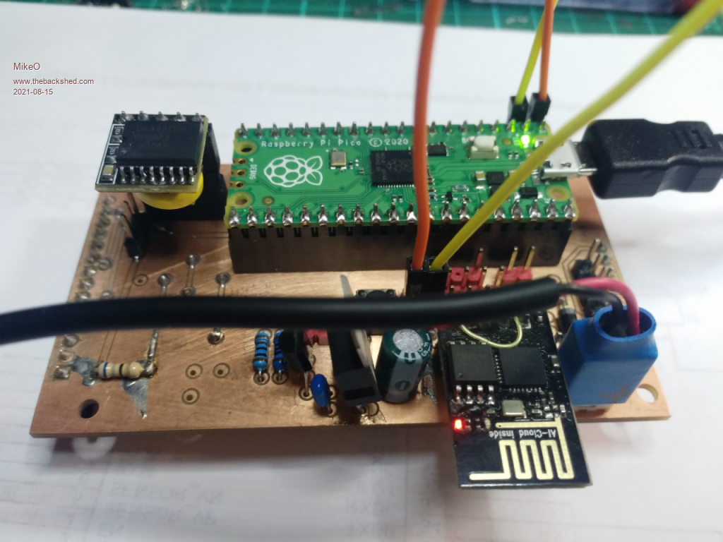

MQTT test using my new, cnc milled, Picomite pcb.
Esp01 loaded with Annex running a mqtt test (using my RPI mqtt broker)
Simple serial receive on the Picomite.
serial.mode 115200
' MQTT test program
' Using mosquitto test server
wlog mqtt.setup("192.168.0.9")
wlog  mqtt.connect("emonpi", "emonpimqtt2016") ' No login / pass required
wlog  mqtt.subscribe("emon/AnnexTest") ' subscribe to the topic /AnnexTest
onmqtt mqtt_msg
for z = 1 to 10
 ' send messages to the topic /AnnexTest
 wlog  mqtt.publish("emon/AnnexTest", "Annex"+str$(z))
 pause 100
next z
wlog  ramfree
wait
' receive messages from the server (send to Picomite)
mqtt_msg:
print  "TOPIC  : "; mqtt.topic$
print  "MESSAGE: "; mqtt.message$
return
Test program running on Picomite shows received subscription messages
> list
SetPin 1,uart0tx:SetPin 2,uart0rx
Open "com0:115200" As #1
Line Input #1,a$
Print a$
> run
TOPIC  : emon/AnnexTest
MESSAGE: Annex1
MESSAGE: Annex2
MESSAGE: Annex3
MESSAE: Annex4
MESSAGE: Annex5
MESSAGE: Annex6
MESSGE: Annex7
MESSAGE: Annex8
MESSAE: Annex9
MESSAGE: Annex10

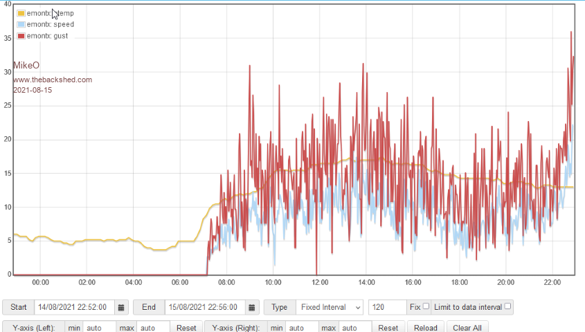

I use a lot of them to monitor sensors for weather , temperatures solar power etc. Mostly I use them flashed with ESPeasy which is extreamly reliable I then send the data via UDP packets. Annex has become quite mature now and especially using an ESP32 instead of the 8266 version would give some enhanced features due to far greater speed and ram memory available , larger json downloads come to mind , processed in the ESP and the required fields just sent to mmbasic . MQTT is another area where the ESP can send data derived picomite for example to a broker on your network (eg rasp pi) for storage and visualisation.
Like this (wild winds here tonight)
Edited 2021-08-15 23:00 by MikeO
