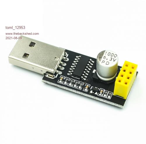

Can the device pictured below be used to flash new firmware into the ESP-01? I don't see a switch on it to allow that. Also, what is the URL of the latest firmware? I see 1.7.4 listed in this forum but when I go to the Espressif website it looks like the latest version is 2.1 or 2.2 and there's a choice of VROOM, WROVER, PICO, and SOLO. Which one (if any) can we use?

Yes if you add a tack switch and a jumper per this YouTube video.  https://www.youtube.com/watch?v=6uaIWZCRSz8&ab_channel=CsongorVarga  It works for me.  I am not sure if that bodge wire is necessary but I did it anyway and it works fine.  It also works as the serial link if you do not push the switch while plunging it in.

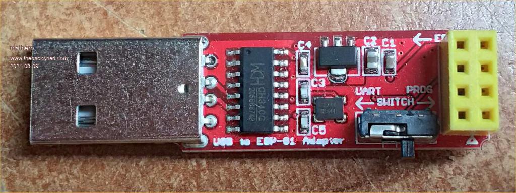

  Quote  Can the device pictured below be used to flash new firmware into the ESP-01?
Don't buy this version. Look for the same but with a switch

Toml--this link shows how to solder two wires (fiddly) to the module you showed and then flash mode is automatically set--no need for a switch.
I've used it many times, and it has greatly reduced my frustration level in flashing ESP-01s.
Use a fine (for smd) soldering iron tip.

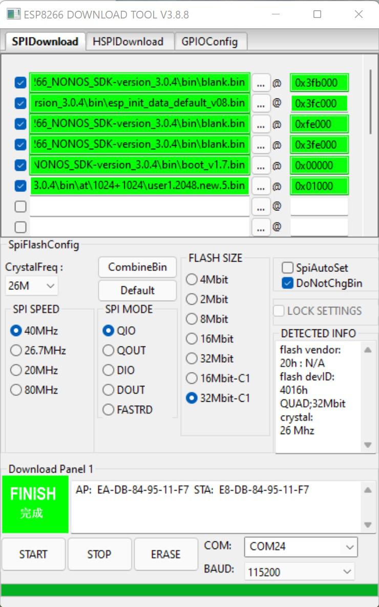

OK, I got one of those. It works fine in UART mode. I'd like to use it to update my firmware but I can't seem to find exactly which file(s) to use on the espressif site. Do you have a URL to the latest version?

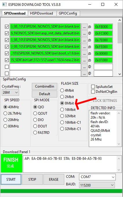

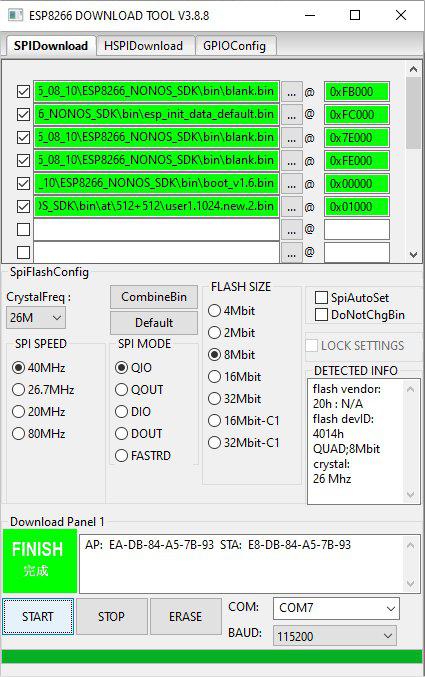

Two months ago I used this 2017 link: flash esp8266
I used flash_download_tools_v3.8.8.exe with this setup:

I found a download site for Non-OS v1.7.4. I don't know what addresses to use, however.
My unit has this configuration:
flash vendor:
20h : N/A
flash devID:
4016h
QUAD;32Mbit
crystal:
26 Mhz
No matter what addresses I use for the files, when I change back to UART mode and start my terminal program (TeraTerm), all I get is a constantly scrolling display of garbage. My flash size is 32Mbit. Does this use different addresses from 32Mbit-C1? The docs don't say what addresses to use for 32Mbit, only 32Mbit-C1. I tried flashing using the 32Mbit-C1 addresses but still get only the scrolling garbage.

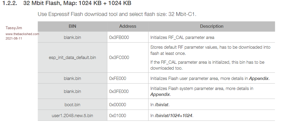

Posted: 03:32am 11 Aug 2021
https://www.espressif.com/sites/default/files/documentation/4a-esp8266_at_instruction_set_en.pdf
The manual has a section on firmware loading.
Have you tried those settings?

  TassyJim said  https://www.espressif.com/sites/default/files/documentation/4a-esp8266_at_instruction_set_en.pdf
Edit:
Thanks. I did try that. Here's what it looks like:

Look at the post by lizby above. Use the 512+512 image and his address settings. If you have a black ESP01 it is almost certainly 8Mbit/1Mbyte
